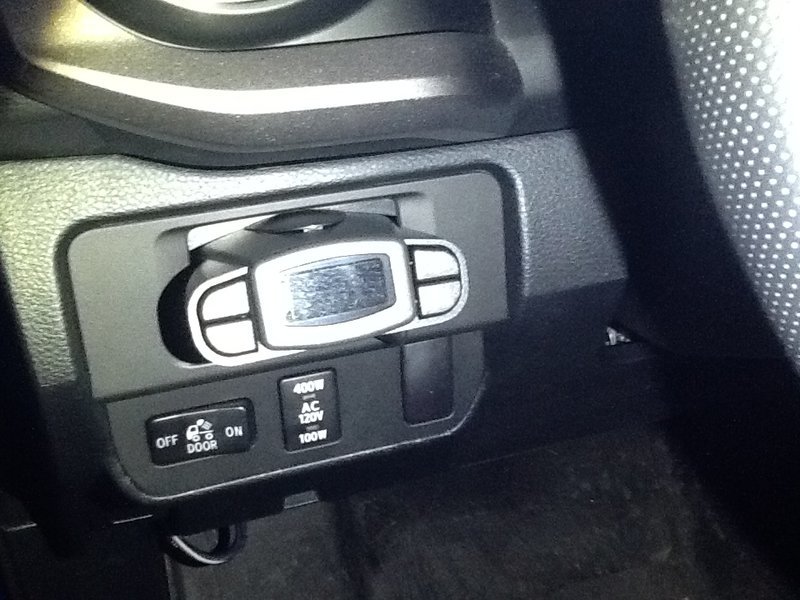

    J Gibson
    J Gibson Well-Known Member
    May 3, 2012
    #78108
    515
    J
    Knoxville, TN
    '12 DCSB,4wd,TRD Sport, tow pkg, MGM
    katzkin leather, toyota step bars, pro grill, advent overhead DVD player, cargo extender, bed mat, husky liners, impulse digital brake controller, avs bugflector, tinted windows, Firestone ride-rite air bags, ARE camper top with tool doors, ScangaugeII, ProEFX tow mirrors, ImMrYo rearview mirror lift bracket, Salex glove box and console organizers, 2020 Tacoma Pro styled wheels, 265/70 r17 Michelin MS2 tires, LED map lights, drivers seat extended and raised, ram ball tech deck installed, blacked out badges, tinted taillights, upgraded climate control knobs, ultimate headlight upgrade with Osram superbrights and wiring harness along wit OEM pro headlight housings.

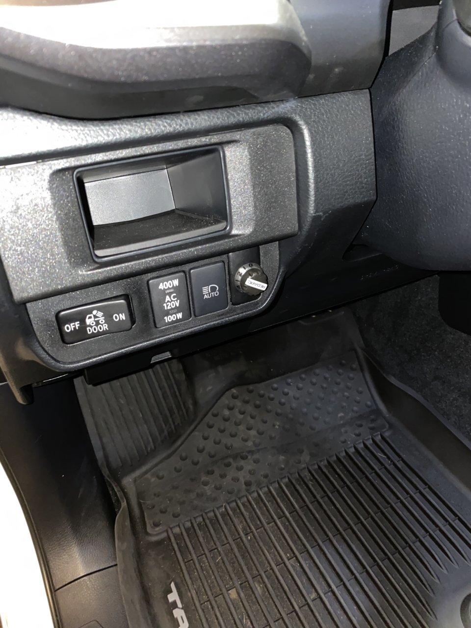

    That is a super clean install. Nice job

    Looks great! I want to do this same install. What wiring harness did you use to get it hooked into the factory plug down in the kick panel?

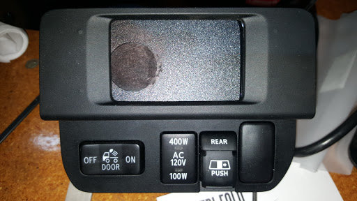

  3. Jan 20, 2020 at 12:26 PM
    #403
    RushT
    RushT Amateur Everythingist
    Dec 10, 2017
    #238171
    5,671
    North Texas
    '18 DCSB TRDOR Inferno

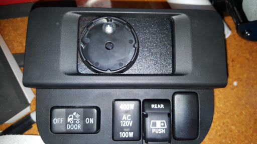

    I did something similar but mounted in a Redarc specific backing plate. I also used a Tacoma specific Tekonsha wiring harness with a few minutes of solder work. Not the best photo, and I still need another blank. This backing plate came predrilled for the Redarc.
    Bob K and Noly[QUOTED] like this.

    I got the wiring harness off Amazon and matched up the wiring.

    Looks good, I actually ordered the plate too. I decided to use the existing spot since I’m not adding any other switches.

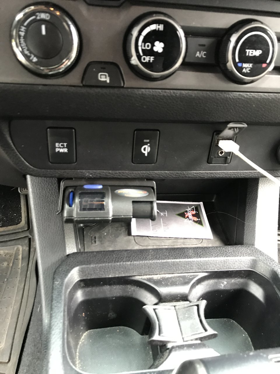

    I mounted mine near the q charger.
    Totally different controller though.
    Cup holder still works too :bananadance:

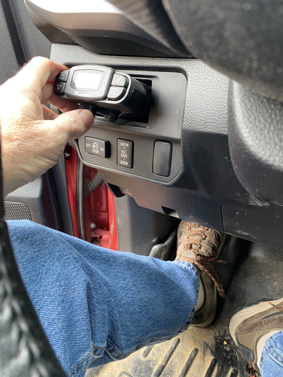

    I installed a Reese Brake-Evn proportional controller this morning, I’m picking up a pop up trailer this week and figured it was time since it’s been in my shed for a couple months waiting for a reason.
    9AE12266-225C-4716-874F-F0F231FBEA55.jpg 2062E54A-A683-4768-ACC7-11AF454336A0.jpg
    thanks for the tips and advice in this thread, make the parts decisions easy to make.

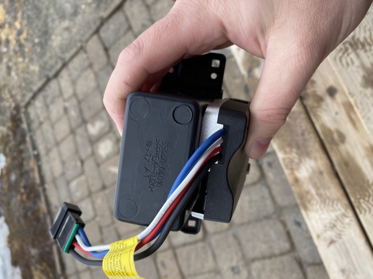

  16. Apr 27, 2020 at 9:13 AM
    #416
    mobgma
    mobgma Well-Known Member
    Nov 12, 2012
    #91006
    214
    Edmonton, AB, Canada
    2016 Toyota Tacoma TRD Double Cab Long Box

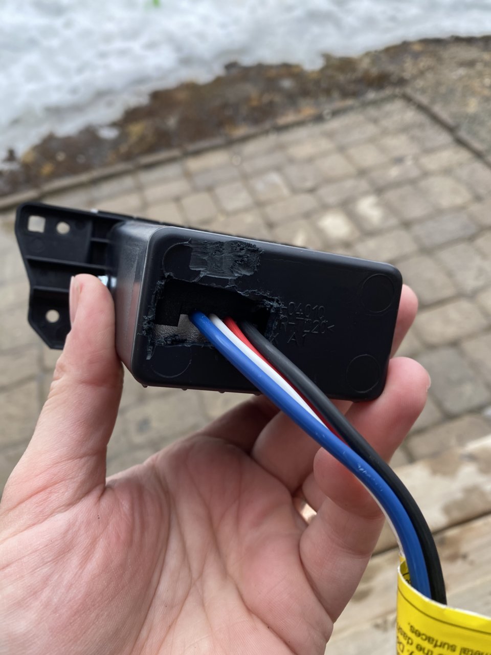

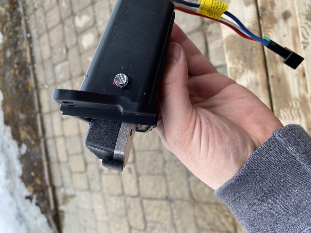

    Did you do an install post? Why is the back of the controller all damaged (where 4 wires come out)?

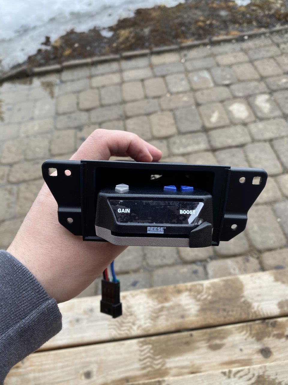

  17. Apr 27, 2020 at 11:11 AM
    #417
    skierd
    skierd Well-Known Member
    Mar 11, 2018
    #247038
    1,224
    David
    Fairbanks, AK
    2021 F150 XL STX Screw 4x4 2.7
    o_O
    Uh the controller is fine. I installed it in the cubby on the left side of the 3rd gen dash. The wires had to go somewhere, so I used my dremel with a cutoff wheel to open up a hole in the back of the cubby, hence the hole and marks.
    I didn’t do an install post but it’s pretty straightforward.

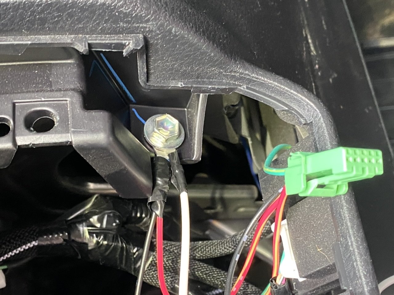

    Remove the kick panel and under dash panel. Plug in the Tekonsha harness to the stock plug behind the wiring harness put the second ground on the bolt under the dash:

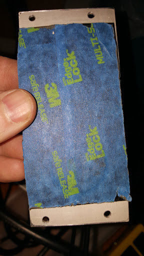

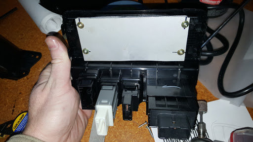

    Pop the cubby out of the lower dash panel, remove it from the holder by removing the four Phillips screws on the back. Slide your controller in so you can mark where to cut the hole for the wires.
    Cut the hole, slide the controller in, Mark where to drill holes for the mounting screws, remove the controller and drill the holes. If you did it right it should slide in and the holes will line up, so mount the controller using the screws, mount the cubby back on it’s panel, then back on the under dash panel, and finally click the wiring together, tucking it up underneath.

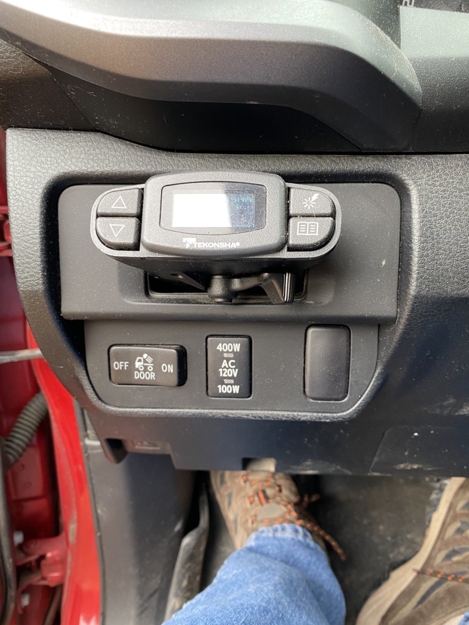

    Read this entire thread, thank you everyone for all your information. I've got some great ideas from you all.

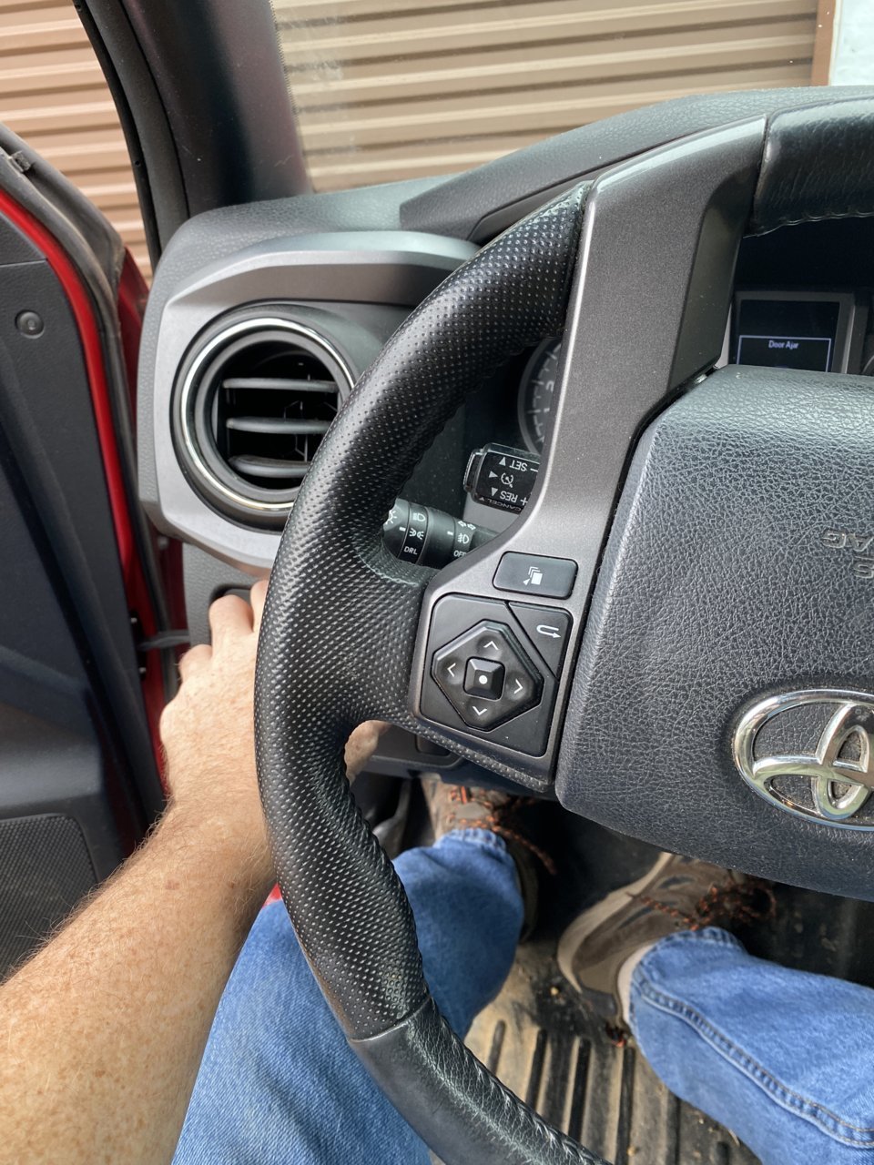

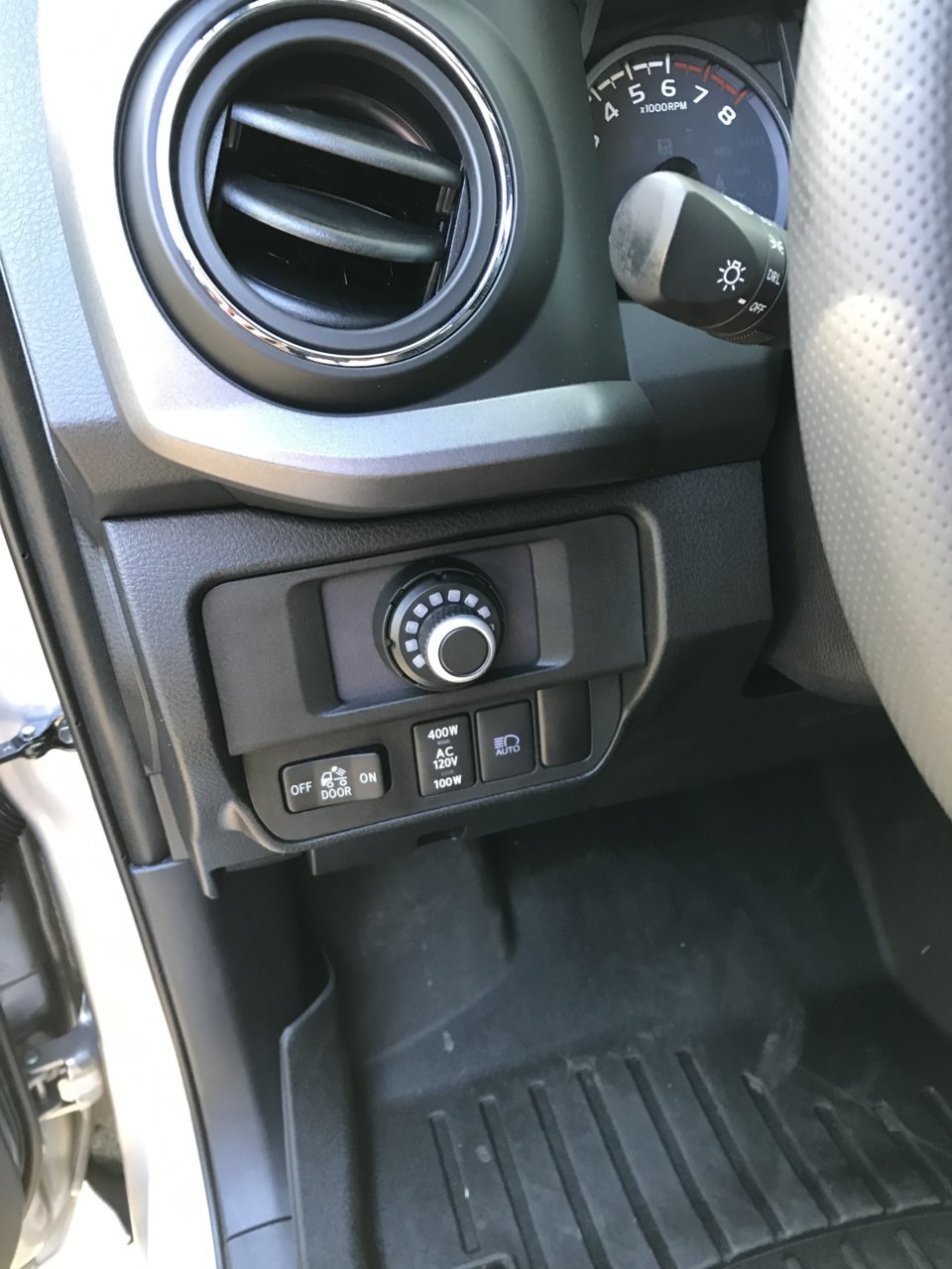

    I have a question of the ease of manual braking. I have't towed much with brakes except for with a REDARC and it wasn't in view so I found it tough. With a Tekonsha 3 do you just adjust the lever to get to manual braking and is it easy to reach just jammed in the cubby? Thanks! -Fish

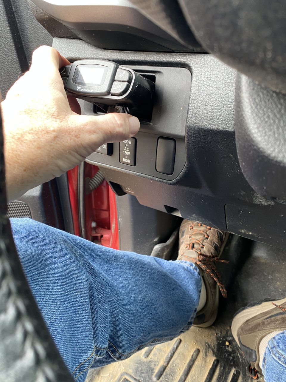

  20. Jan 18, 2023 at 1:35 PM
    #420
    Eaglecarver
    Eaglecarver Member
    Apr 21, 2016
    #184930
    11
    Roger
    2016 Tacoma TRD Sport
    It is an easy arms distance from driving position and not hard to manual ly break if you need to, although I never have needed to do it with what I haul. Here are some pics from different views. It is slightly out of view sitting in normal position but easy to find and reach. other show the lever when mounted like this.
