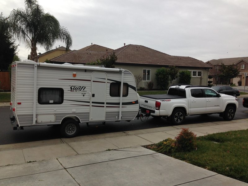

  8. Dec 23, 2015 at 4:55 PM
    #68
    Mavric31
    Mavric31 Well-Known Member
    Jul 10, 2015
    #159199
    214
    2016 DCSB TRD Sport Super Awesome Edition
    Finally towed with her. I couldn't be more happy!

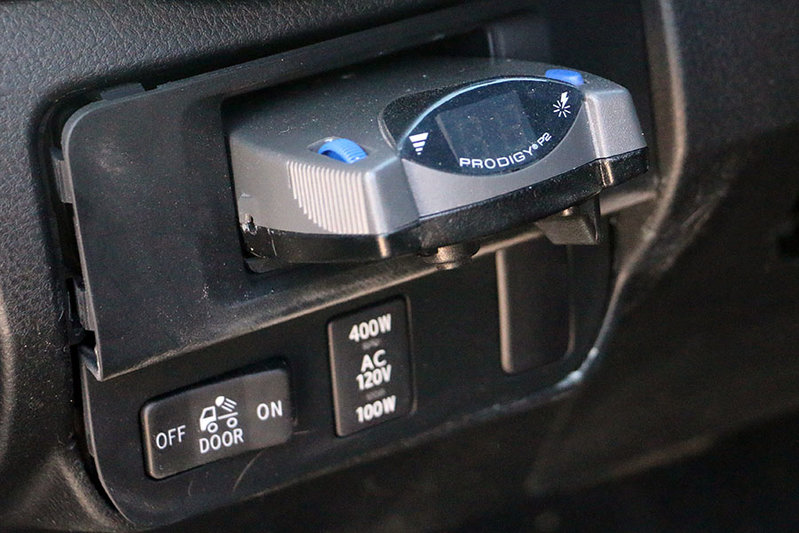

  20. Jan 4, 2016 at 11:01 AM
    #80
    krazyscot
    krazyscot Active Member
    Mar 9, 2014
    #124926
    34
    Stuart
    Colorado Springs
    Bearing in mind I haven't popped the cubby back in so that I can install the harness when it arrives, this is where I'm installing my brake controller. The manual switch underneath necesitates it sitting out but it doesn't get in the way with airbag under dash or the diagnostic port and reset button by left ankle or the tight space above the right ankle. The only other real option would be to extend harness wiring and move it to center console above the charging mat, but I really didn't want to start cutting wires etc. This will do fine for me!
    brake controller.jpg a
