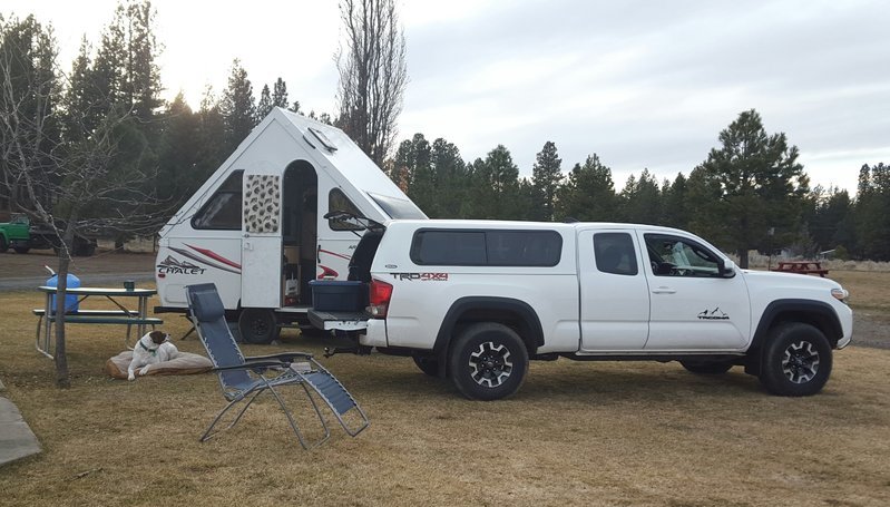

    Pulling my Chalet all over the western US with the 16, just as I did with the 02.. Trailer tongue wt at 280+/-. Will put airbags on.... likely, but not definitely. Had them on the 02, was a good thing.
