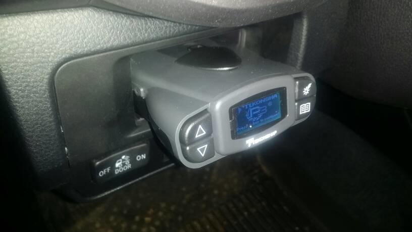

    I have the P3 ordered from Amazon. A local place had a lower model for almost the same cost. But it wouldn't fit in the cubby hole.

    I got the P3 yesterday. It is a tight fit into the cubby hole. Were the earlier ones also tight? I'm wondering how far to push it back.

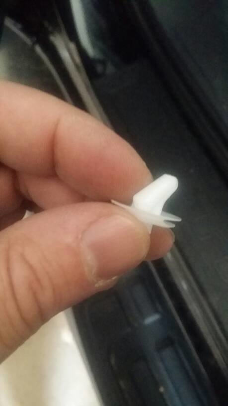

    I installed my P3 today. I broke one of the plastic push connectors on the kick panel. I tested it out by hooking up to the trailer. It seems to recognize the trailer. I didn't drive it yet though.

    I pushed mine in until the hinge point on the brake lever (bottom of the unit) just touched the dash.
