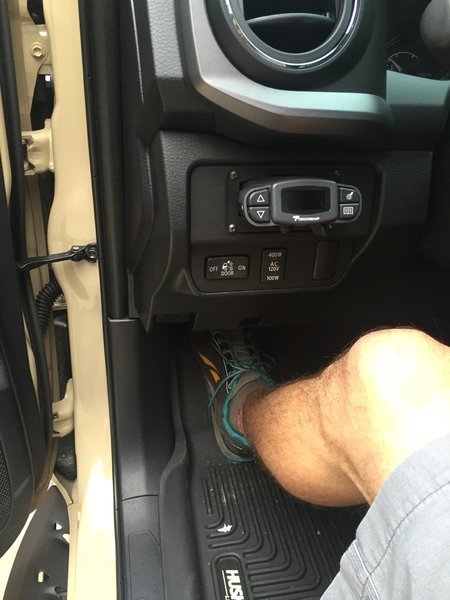

    It's low and to the left... sticks out 2 or 3 inches. I only notice it when I'm getting in and out of the truck. Perfect spot to me...

    I used my Tacoma with the Teconsha P3 today. Reading the adjustment directions it said to continue to increase the voltage number from 6 until the trailer skids when using the manual brake control. It took until setting 9.5 or 10 before the 3000 pound popup camper trailer would skid. Does that seem high? On my initial drive using setting 6 the temperature of the brakes was only 85. At setting 9 later the temp was 195. The trucks brake temp was 190 each time.

    I have my Tekonsha Voyager mounted the same way. I prolly COULD have installed it in the 'lil cubby hole like I see in the pics in here, but I had it like this in my '02, and I like it here (on the underside)
    Personally, (and I mean this is STRICKLY MY opinion) I simply cannot warm up to the looks of the install in that cubby, in spite of the location looking very good. I use the cubby hole for business cards and like items.
    Argument comes back to mounting the controller underside, "man, that's a shin killer". Well, I never make physical contact with it mounted there. Close, yes. Hit it? No.

    I tried and Voyager is a bit wider than the cubby hole, does not fit.

    No, I used a mounting plate from my tundra , I took out the cubby, drilled holes, and bolted it on. Easy, clean, and secure.
