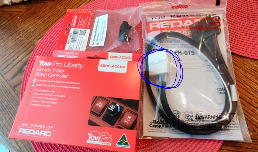

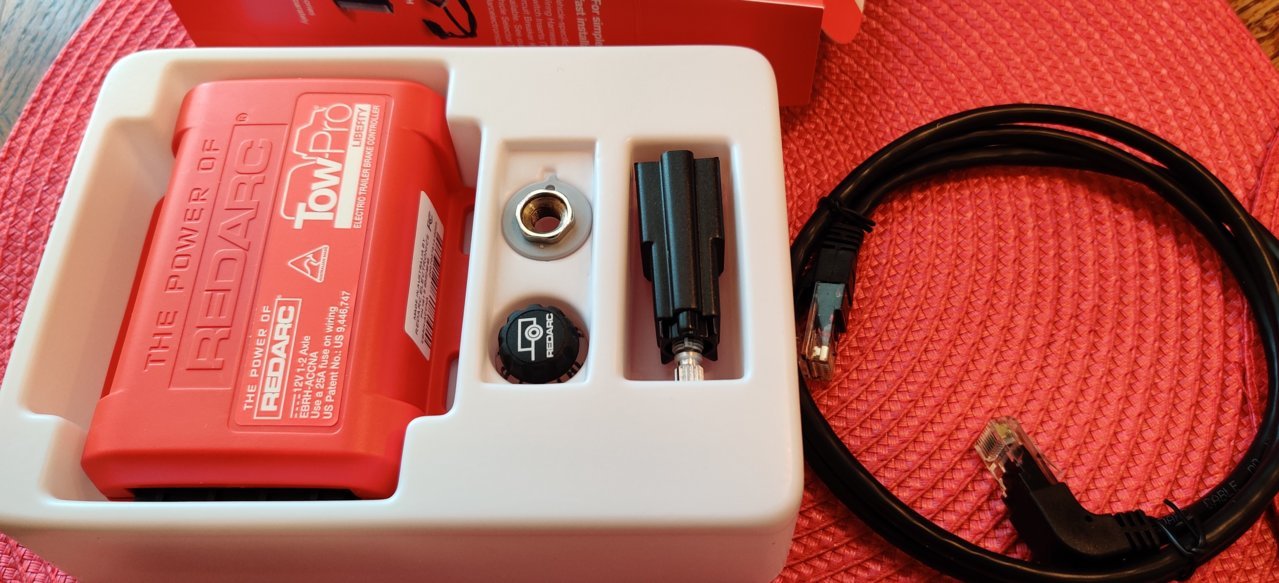

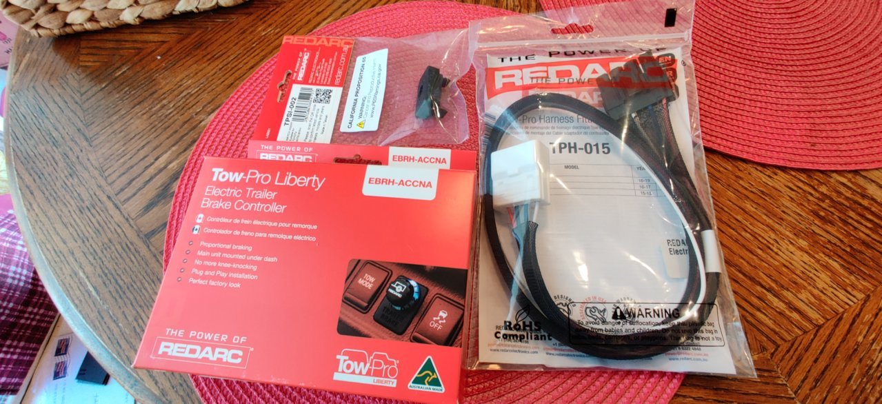

    I got the RedARC tow pro liberty that I ordered Saturday morning already today on Wednesday afternoon. Here is what I got in my order and what came in the box. I'm going take a quick look as to where the best place to mount it under the dash is keeping in mind it has to be secured and not just zip tied in tonight. I will think about how exactly I'm going fix in the truck over the weekend.

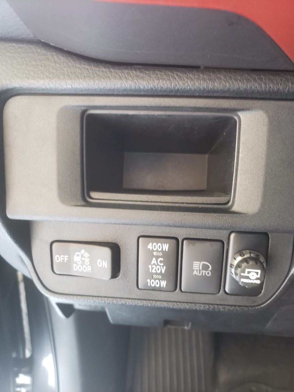

    That says the plate uses the taller narrow switch. Redarc sells a plate for the tall one and the shorter one.
    I got the short one. Looks like it will fit next to the traction control button. That might be useful if you don't want your cubby. 2020 models don't seem to the cubby any more so that plate is good for 16-19.
    For the 2020 you can pick either size switch plate from RedArc depending on what openings are unused on your truck. For my SR5 I have few switches in there. If you have a TRD you have the outlet one and the camera one with that package in that panel.

    Looks like you've got the 2020. I used the official Redarc plate as well.
    If you're talking about the actual proportional controller box, this may not be the most ideal way of doing it but I'm confident it'll be fine: I just attached it to the side of the ECU mount (or whichever computer controller is under the driver's side dash) using two sided adhesive. I don't think it will ever fail but if it does, it will be evident really quickly. No picture unfortunately but when you get under the dash you'll see it pretty clearly. Nice large blank spot.

    That is exactly what I'm doing. I was peeking under the dash near the kick panel. I think it's a fuse panel. Anyway it meets the "large blank space" discription well. My intent was to pick up some 3m extreme double side mounting tape and put it there. I thought about zip ties around too as a back up but not sure it's worth the effort.
    Looks like you have the same switch blank from them for the knob as I do. So it should look the same.

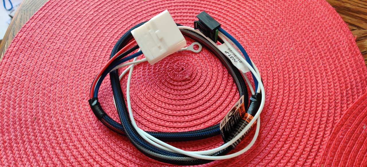

    2020 TRD OR, DC-SB, AT

    IMG_20200828_171357.jpg The white plug is what plugs in to the trucks harness behind the kick panel. This is the Tekonsha harness I bought for the Tacoma before I decided I wanted to go with the RedARC. Notice the white end is the same in the photo of the RedARC as the Tekonsha. The other end that's black on both is the controller end. The RedARC has a larger connector on the controller end than Tekonsha
    The Tekonsha part number is 3031-P it has the white ground wire. There is one with out the ground but I think it isn't being made any longer. There is a grounding point in the kick panel the white wire gets bolted to. The RedARC harness also had the ground too.
    I have the 3031-P harness for Tekonsha and since I'm probably going to leave that control go with the Jeep and not move it to my Tacoma I'd like to part with it but I'm past the Amazon return window.
