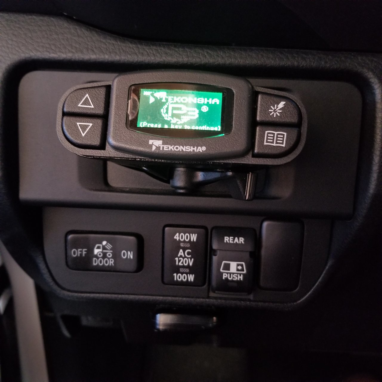

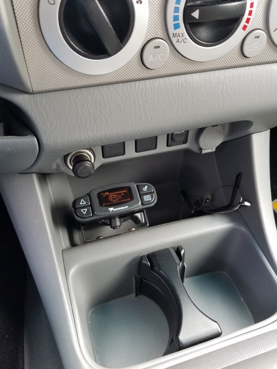

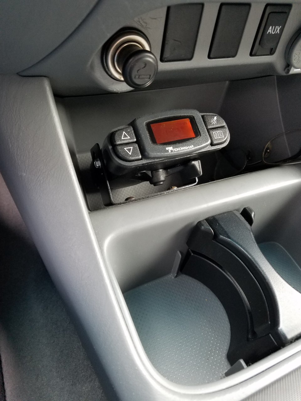

    Mounted my P3 in the dash with a kit from ESP Truck Accessories.Tekonsha P3.jpg

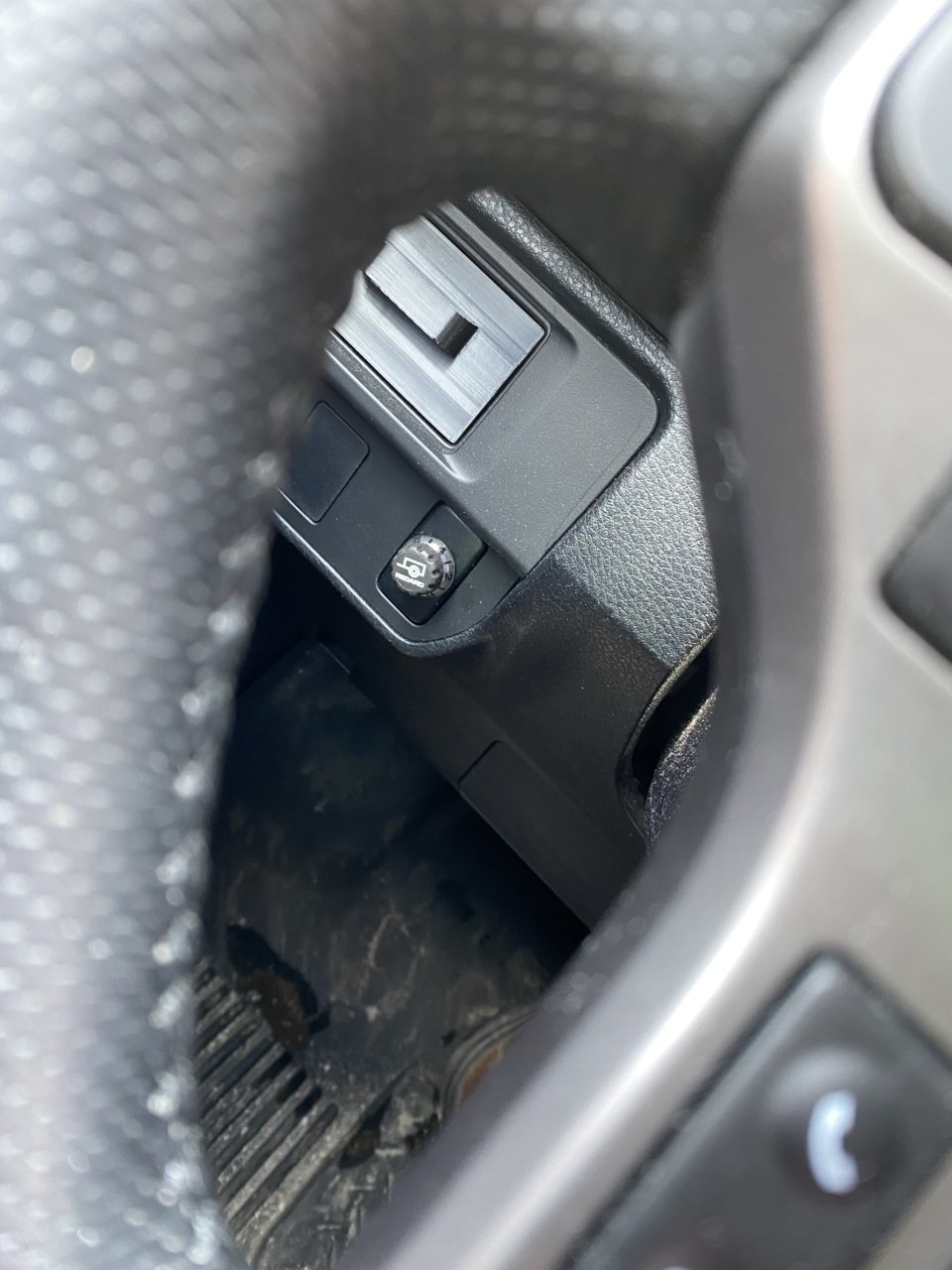

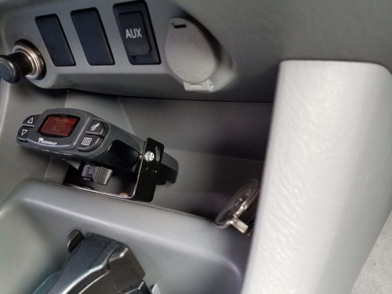

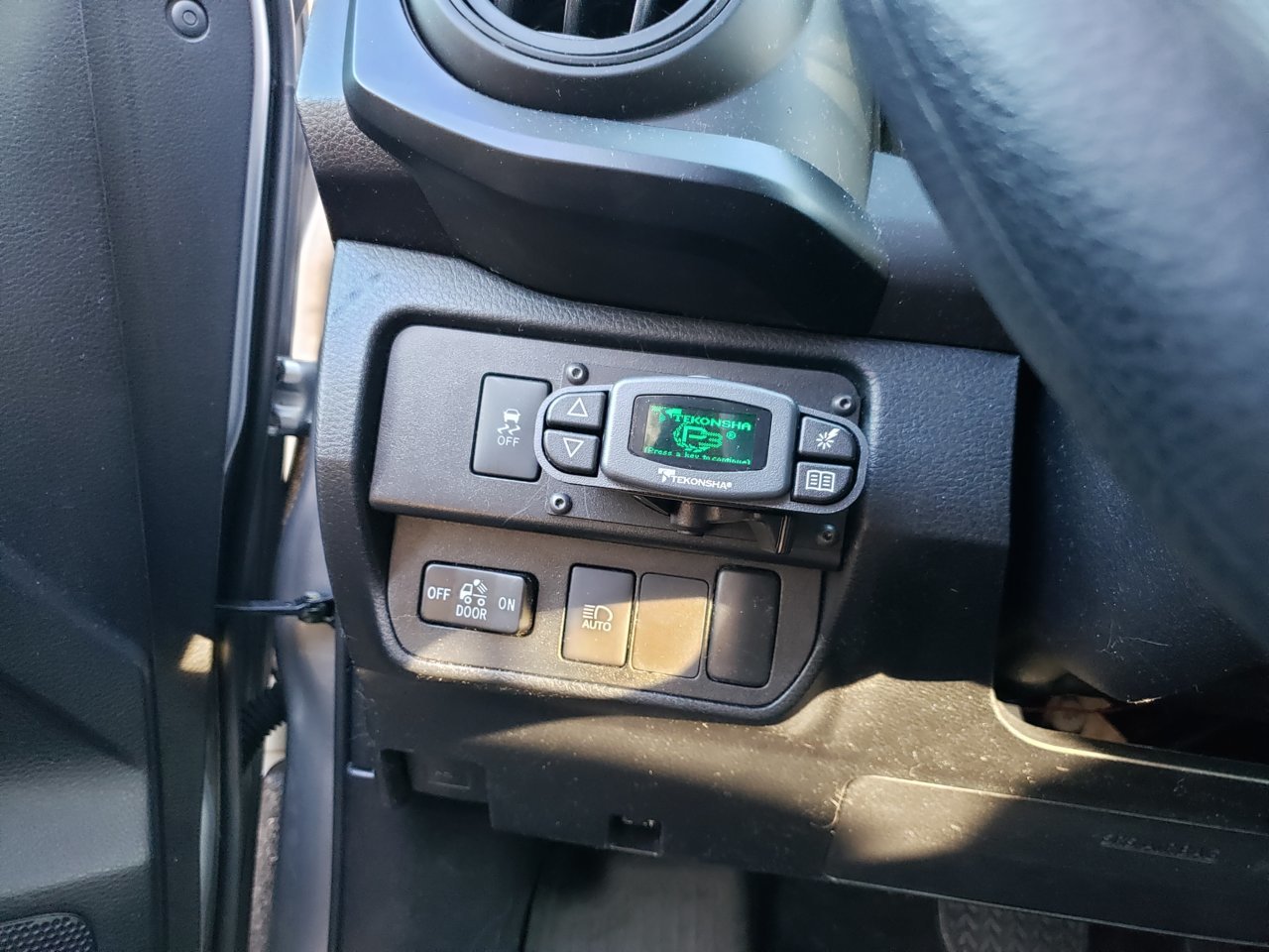

    I mounted the P3 in my 2020 SR which requires more cutting than I wanted but I had already purchased so went ahead and cut the hole and a piece behind the plate. If I were to do it again I would just get the redarc, much cleaner. 20210228_172811.jpg 20210228_172821.jpg

    What harness did you use to tie into the stock one ?

    Installed the Redarc in my 2016 today used their plug and play harness very easy and just a little extra cabling that easily fits behind the kick panel.
    I did run into a problem when removing the lower dash panel I had to take the hood release cable out of the pull mechanism and now can't get it back in. Anyone experienced this have suggestions on how to get the cable seated again?

    I had the same issue but just kept at until it popped in place.

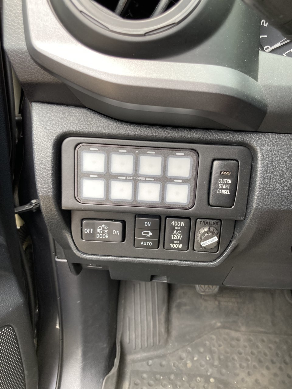

    I received the correct gen 3 harness for the P3 and finished the install today. 20210307_163711.jpg

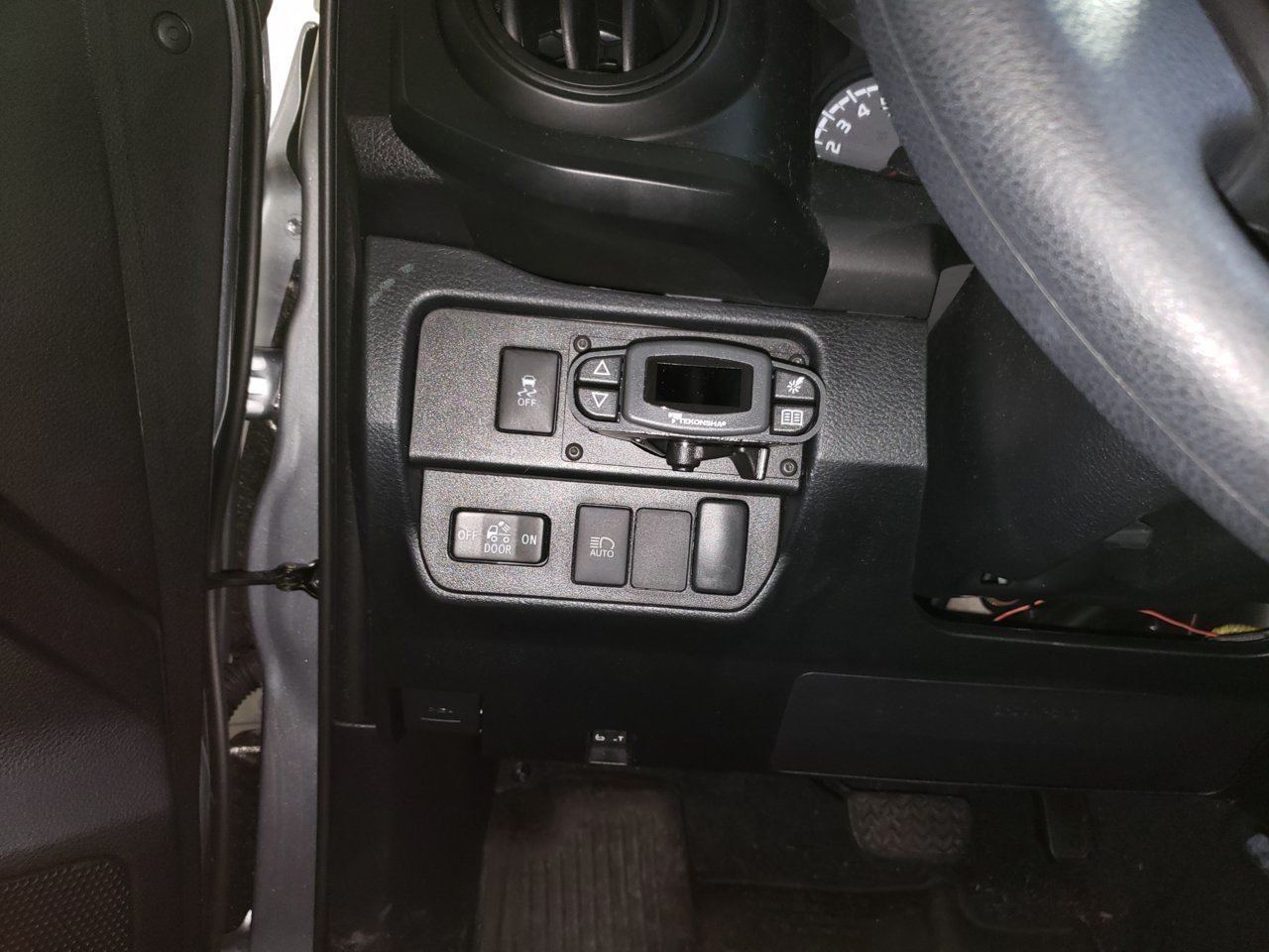

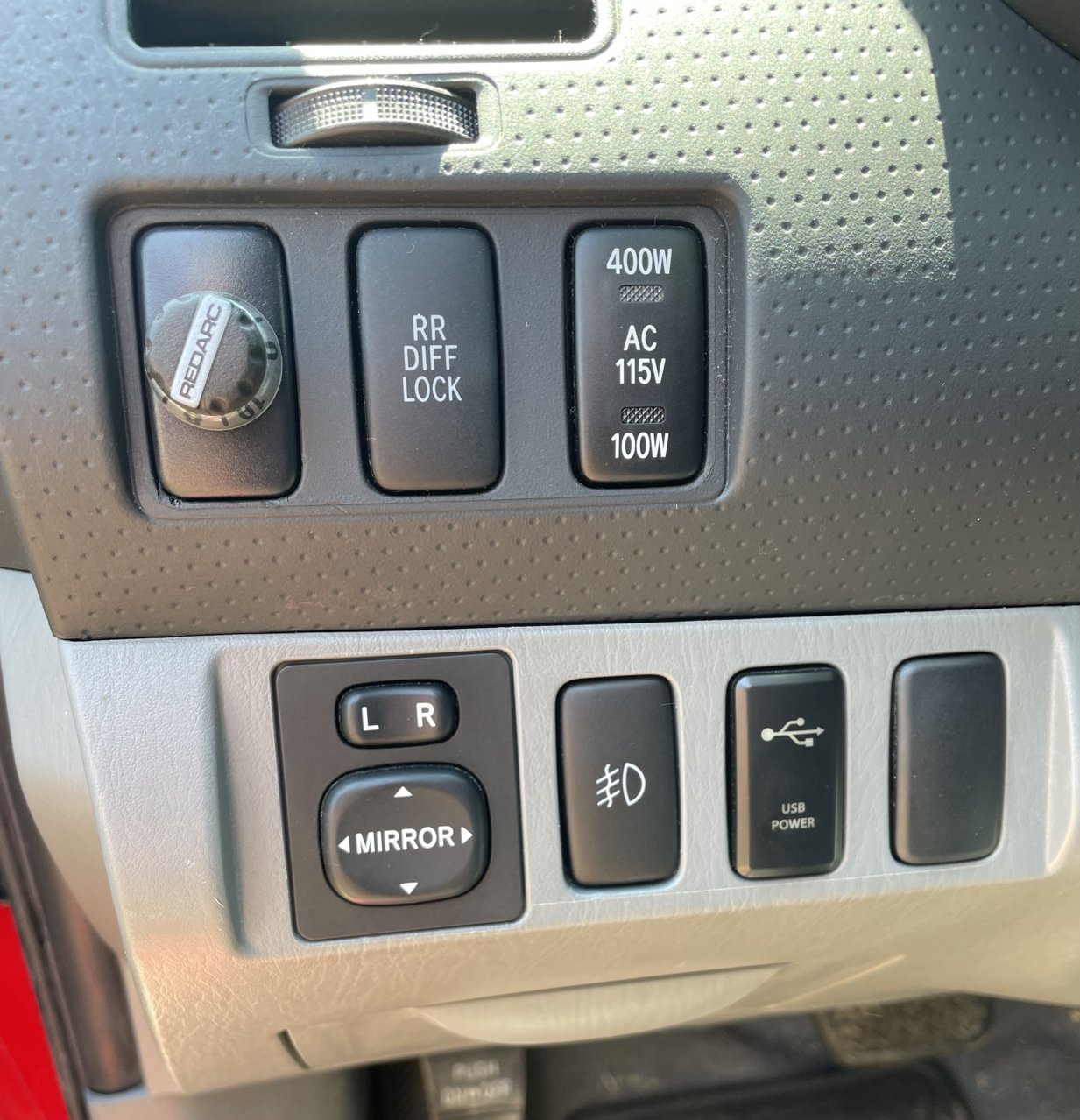

    I like what everyone has said about the REDARC set up. I hadn’t heard of it before. I put a P3 in my truck 2 years ago and love it. Also got the pigtail so it would be plug and play. No splices. Even I couldn’t mess it up. C6103FE3-C02C-4A09-A9AC-B4BA6CEE3FE7.jpg 19642FAA-8B65-42E2-82F1-E35A50BB5E1B.jpg E562FA0A-1DEA-4FEF-BA96-27B21F5E7D84.jpg Did get bloody knuckles digging around for the factory part of the harness by the kick panel.

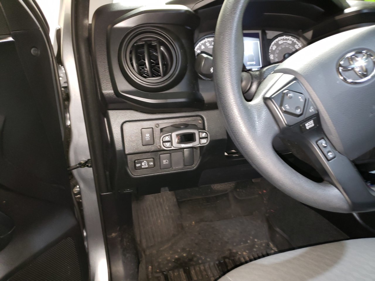

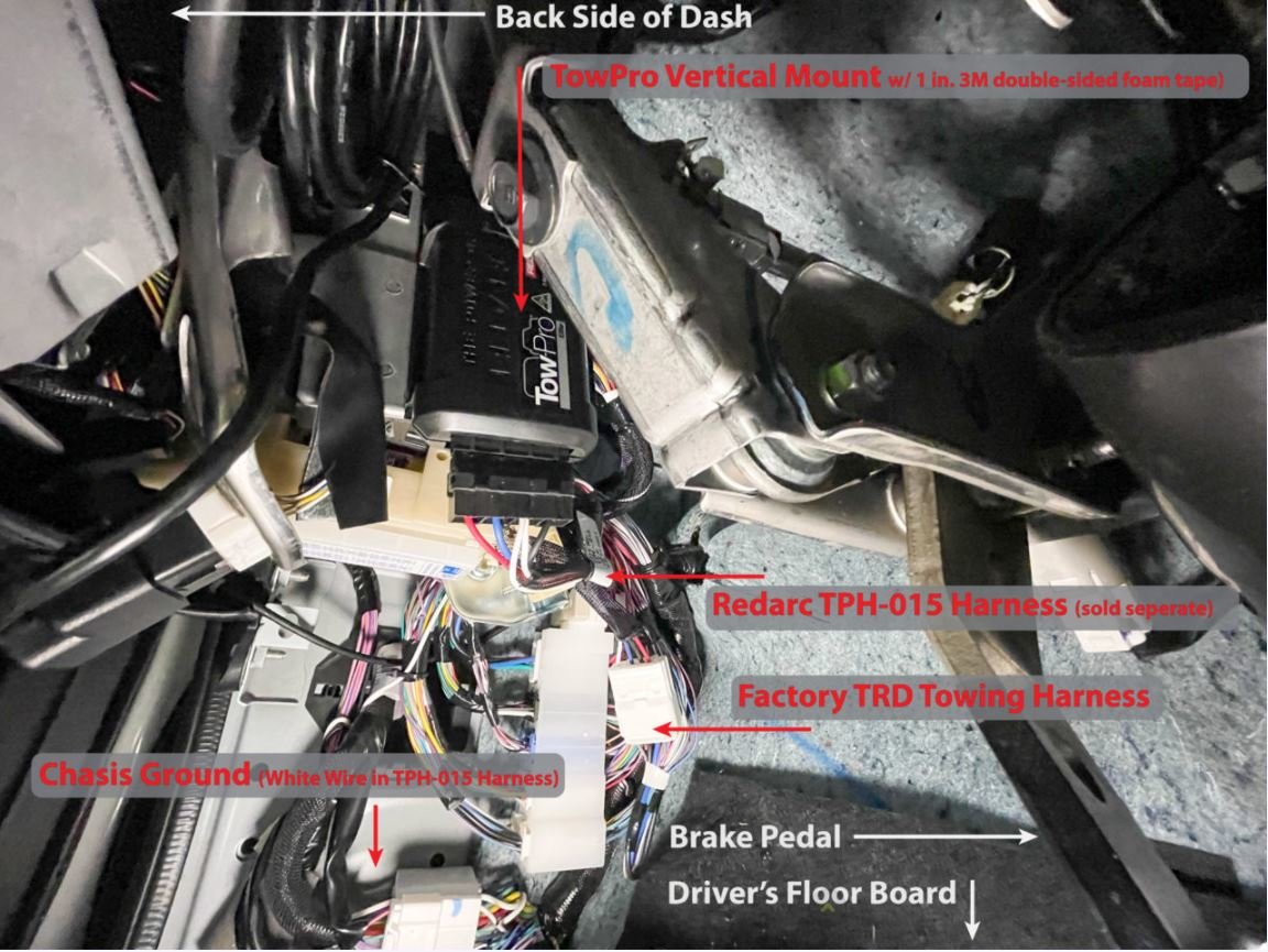

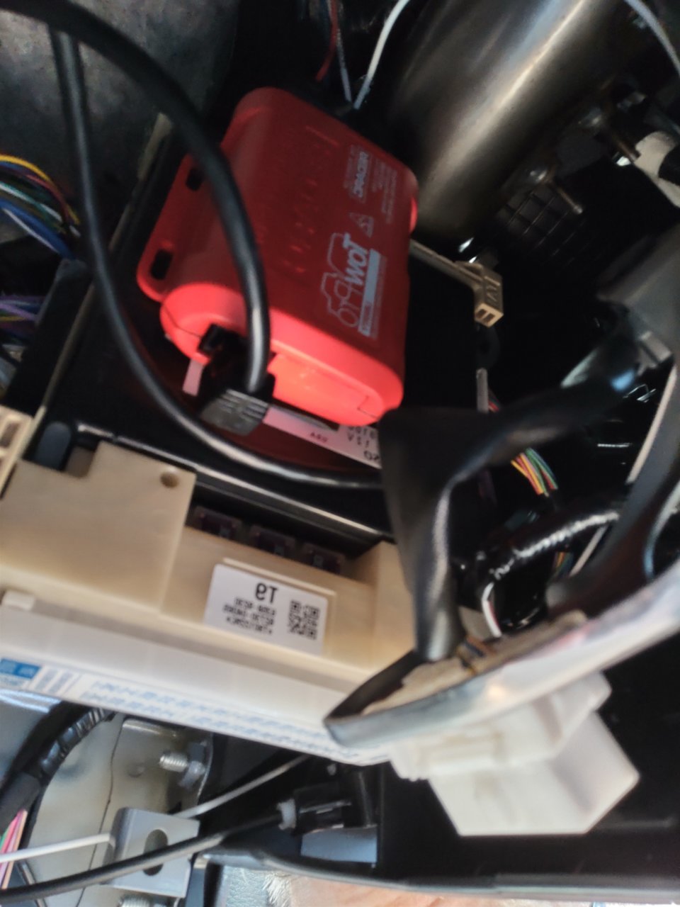

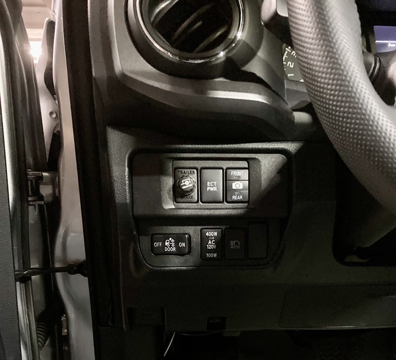

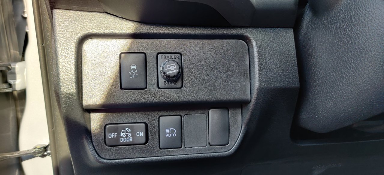

    TPH-015 as pictured. I installed a Tow Pro Elite in my Gen 3 earlier this week. The TPH-015 harness from Redarc plugs directly into the factory TRD towing harness and the white wire needs to go to the chassis ground. I used the ground on the side that the other connectors use. It is secured with a 10mm nut if I remember correctly. I have a few more pictures in this post .
