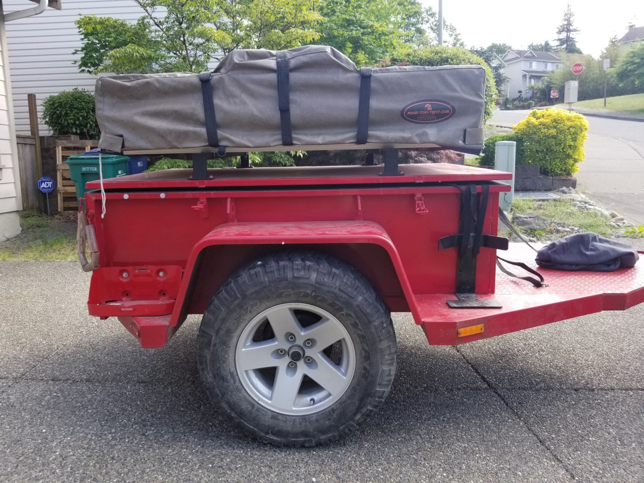

    Yes, I'm still here. This summer has been really busy.
    Tongue length is 71". It a solid square tube that is part of the structure of the frame. I believe the frame tube was 10ga wall, and the tongue was 3/16 wall tube. I wanted something that was going to be light, but also had to support my needs.
    My axle length is kind of a love hate relationship right now. Driving on mountain roads and trails it tracks the same as my truck tires. I don't have to worry about my trailer tires going off the road in turns. But on long straight roads like to see my tires. I like to keep an eye on them since it is only a single axle trailer. I want to say they're about 46". I'll have to double check my notes at work. So far, everything is working out really well. I don't really have any regrets on my design. I did a lot of research on other people's trailers. Then put all the things I liked into mine. Hopefully this helps out some.20190706_144812.jpg
