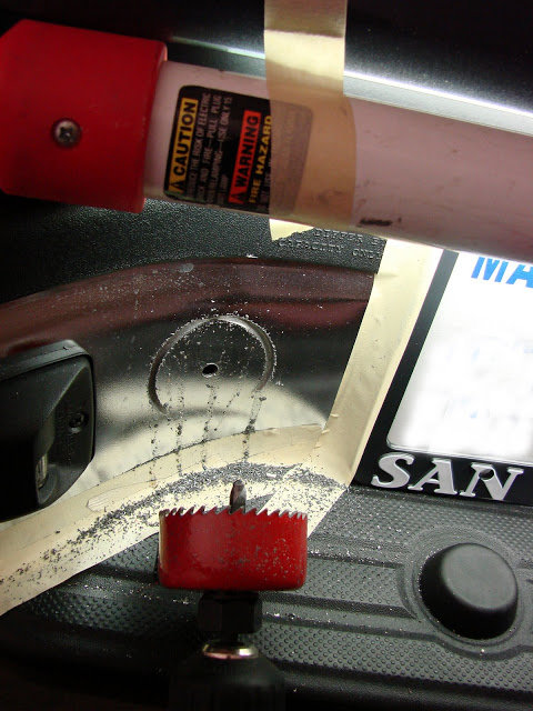

    Hole saw was easy and I guess the license plate light makes it easy to see if I need to mess with the plug at night. No flashlight needed :D

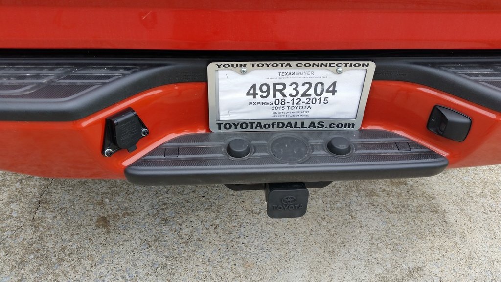

    It is literally like its meant for it.
    And if you are good with the hacksaw only cut what you need off (very minimal), leave the top lip on the backside of the plug and you will be able to use it to hold the top of the plug in place on the bumper. Only other thing you have to do is flip the 90* plastic wire guide 90*... which is as simple as removing the electrical tape around the junction between it and the main body of the plug, and spinning the plastic bend.
    You will understand this when you remove the harness from the truck itself.

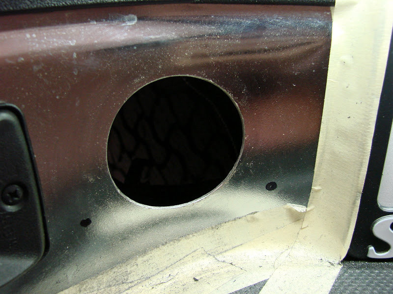

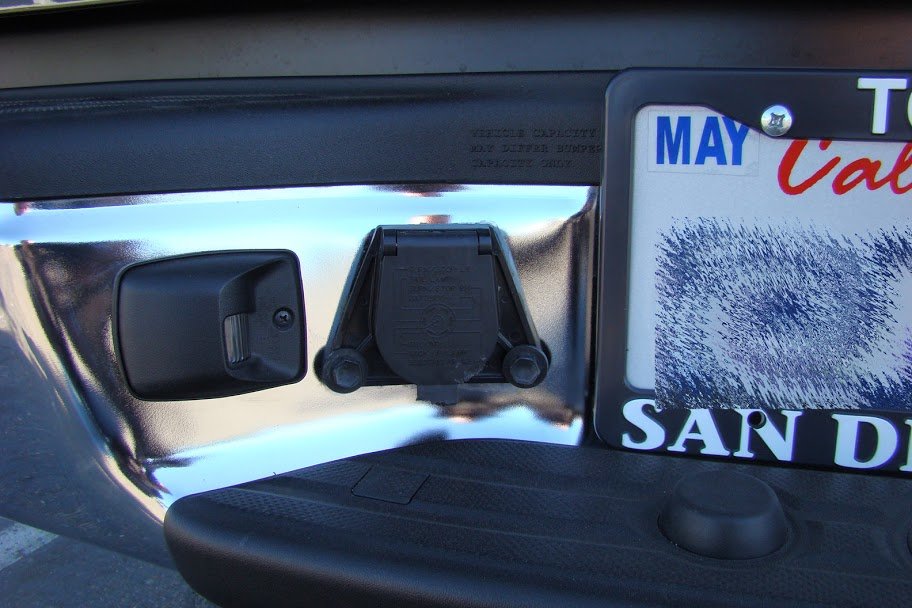

    The reason I drilled a hole was I didn't want to sacrifice one of the two license plate lights. Two is better than one, I don't care about illumination for readability, only legally. If one bulb let's up, the other keeps me legal until I can replace. But I tend to agree with the Lord of War, that you only need one to be legal, presumably in all 50 states.

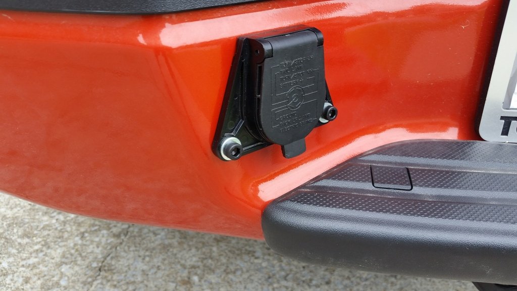

    I need to paint these washers black, but I'm happy with it.

    Took like 10 minutes total. I think I spend more time at the hardware store getting the bolts and nuts.

    Crom - did you drill the hole where the bumper is curved? If so, how did you get the bracket to sit flat? Did you seal it? Thanks. Great mod!!

    Yes, curved part. Just made a silicone gasket.

    Crom placed his in a new hole in the bumper, which is why I'm guessing he needed a gasket. Mine is also in the driver's side license plate light hole, and I only trimmed some plastic on the plug and drilled two holes for the bolts. No gasket needed.

    Surface is not flush, so you need to compensate for that, add long as you're good with that, it's great. It'll be 7 year old mod soon, and I'd do it again tomorrow the same way if I had to.
