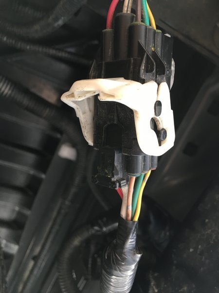

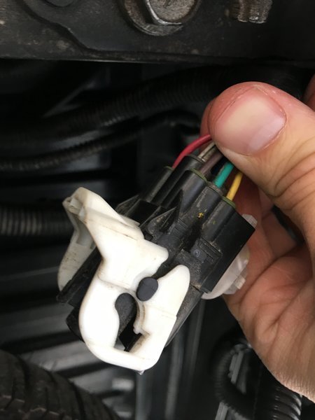

    You don't take it apart at the 7-pin. You need to disconnect the rather overly complicated harness connection up behind the bumper. You'll see an unusual large white clip-looking thing. Do not try to pry that open. Instead, to the right (inboard) edge of that, is a tiny little double-pronged black clip release. It's a little fiddly and tiny, but pinch the prongs together, and that allows the big white clip to pop open, which allows the harness to be separated.
    You'll need to cut a little tape on the split loom too to free the whole 7-pin pigtail.

    I did this mod today. Took pictures of the connection.

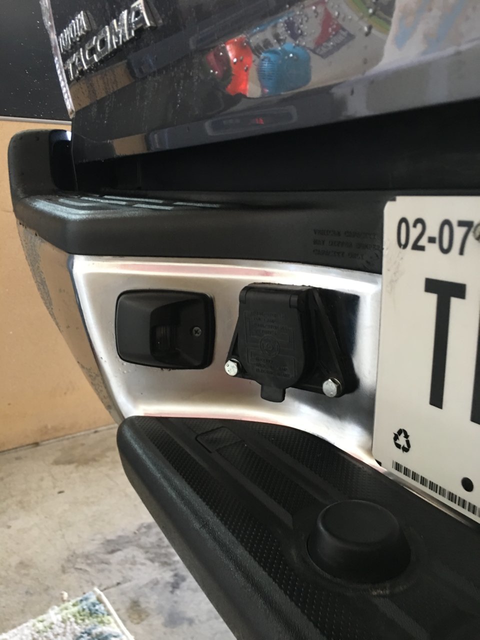

    I had to enlarge the hole for the driver side license plate light just a little bit (dremel tool w an abrasive disc), but I think this is a pretty clean install. IMO, it more closely matches the passenger side license plate light housing (because the mounting tabs are hidden behind the bumper's sheet metal). If I had to do it over again, I would have created a template for the hole to more closely match the receptacle's shape, rather than a simple rectangle.

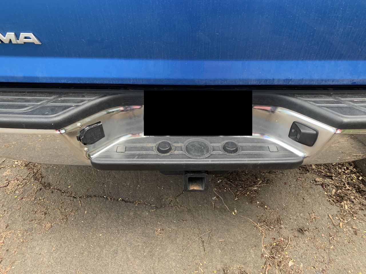

    @Rick_Taco - I have been watching "Live PD Police Patrol" and you are correct. They pull you over for one thing and then some pull the, I smell "Alcohol" or "Weed" which then gives them probable cause to detain you and search your vehicle. I personally wouldn't have any issues since I don't do either but I decided that I will drill into the bumper and create a separate location for the harness adapter. Doesn't seem to hard and gives that extra assurance as you mentioned.

    it’s pretty easy. About 10 minutes and a 2” hole saw. Let us know how your set up works out. Everything I pull uses the old rectangle adapter. I keep an adapter in the truck at all times.
    if I did it again, I would have installed a license plate hinge and hid it behind there.
