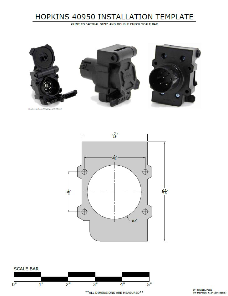

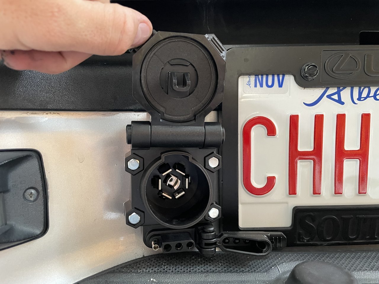

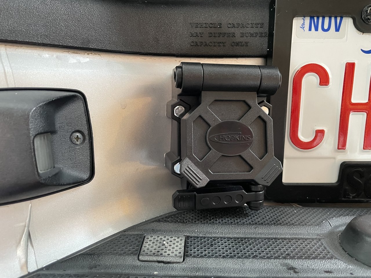

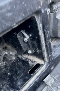

    Finally got around to changing and relocating the trailer plug.
    Very easy install and I didn't run into any issues.
    I used the Endurance Hopkins 40950 Multi-Tow 7 Blade and 4 Flat Vehicle Wiring Kit:
    https://www.amazon.ca/gp/product/B00W1O2FQ0/ref=ppx_yo_dt_b_asin_title_o06_s00?ie=UTF8&psc=1
    And used the Hopkins 40985 Universal Multi-Tow Harness Connector:
    https://www.amazon.ca/gp/product/B005Q87T6E/ref=ppx_yo_dt_b_asin_title_o00_s00?ie=UTF8&psc=1

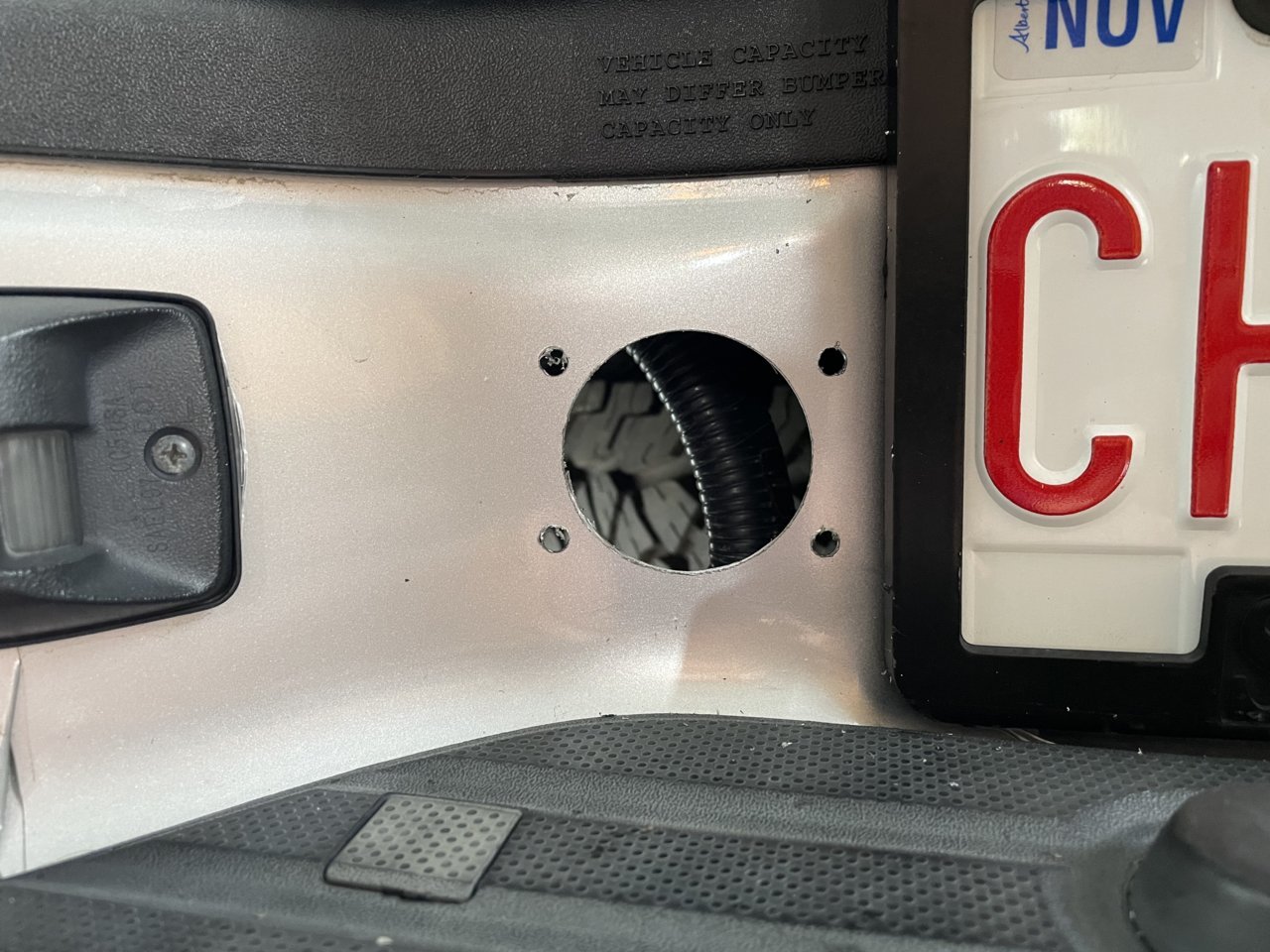

    Holes drilled:
    Closed:
    Open:
    Why can't anything just match up...
    The new Hopkins plug is wired the SAE Standard way and my Taco is wired the RV Standard way.
    That's why some of the colours are mismatched.
    I created a template for the Hopkins trailer plug. See the attachment.
    Make sure you print it to "actual size" in your printing settings so it is to actual scale. You can double check by confirming the dimensions on the paper. These dimensions are "true" and I used a caliper to measure the plug.

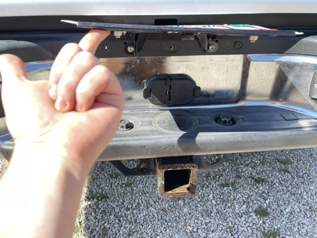

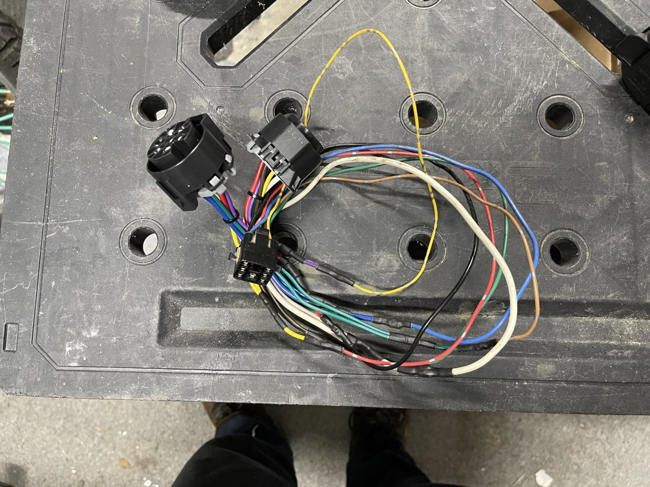

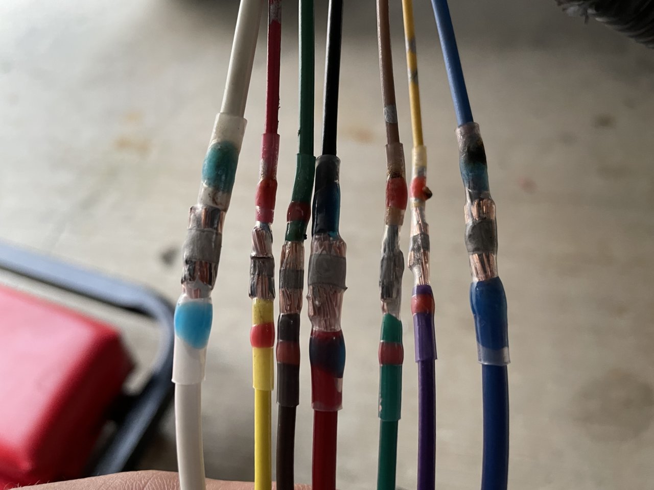

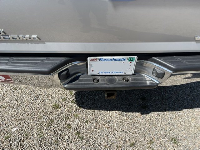

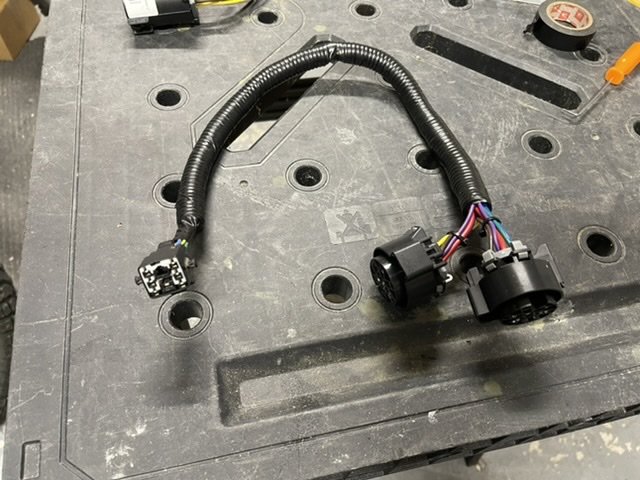

    here’s my version I did over the weekend to move the stock 7 pin tow harness. I modified the original harness to go from the Toyota 7 pin plug to the OE style. Now it’s a 7/4 pin 3rd gen style plug behind the license plate on a sprung plate holder and out of harms way underneath. I figure if I’m trailering my plate isn’t visible anyway. I used an OE 7 pin splitter because I have a second 7 pin plug in the passenger storagecubby next to the 120v plug for the camper.79B01A02-83DD-4E17-8872-7EB44EF568B9.jpg79953DBE-B2CB-4C5D-A0C2-5D8CACC1024F.jpgC51AFFA8-1FC1-49FC-98F5-4AECDCBCA78D.jpg31EE7287-5F16-46A0-864B-C3B9B828CDEB.jpg

    Not to my knowledge, otherwise I wasted about an hour of my life. I only modified it to have two available OE connectors at once for the truck camper and the trailer. Your best bet with no splicing would be to reuse the hanging 7 and simply relocate it to the bumper...if its any consolation the tow harness is removable and makes splicing much easier on a workbench.

    I hear ya, I staggered the connections to mitigate the bulk then soldered and marine heat shrink on the connections.

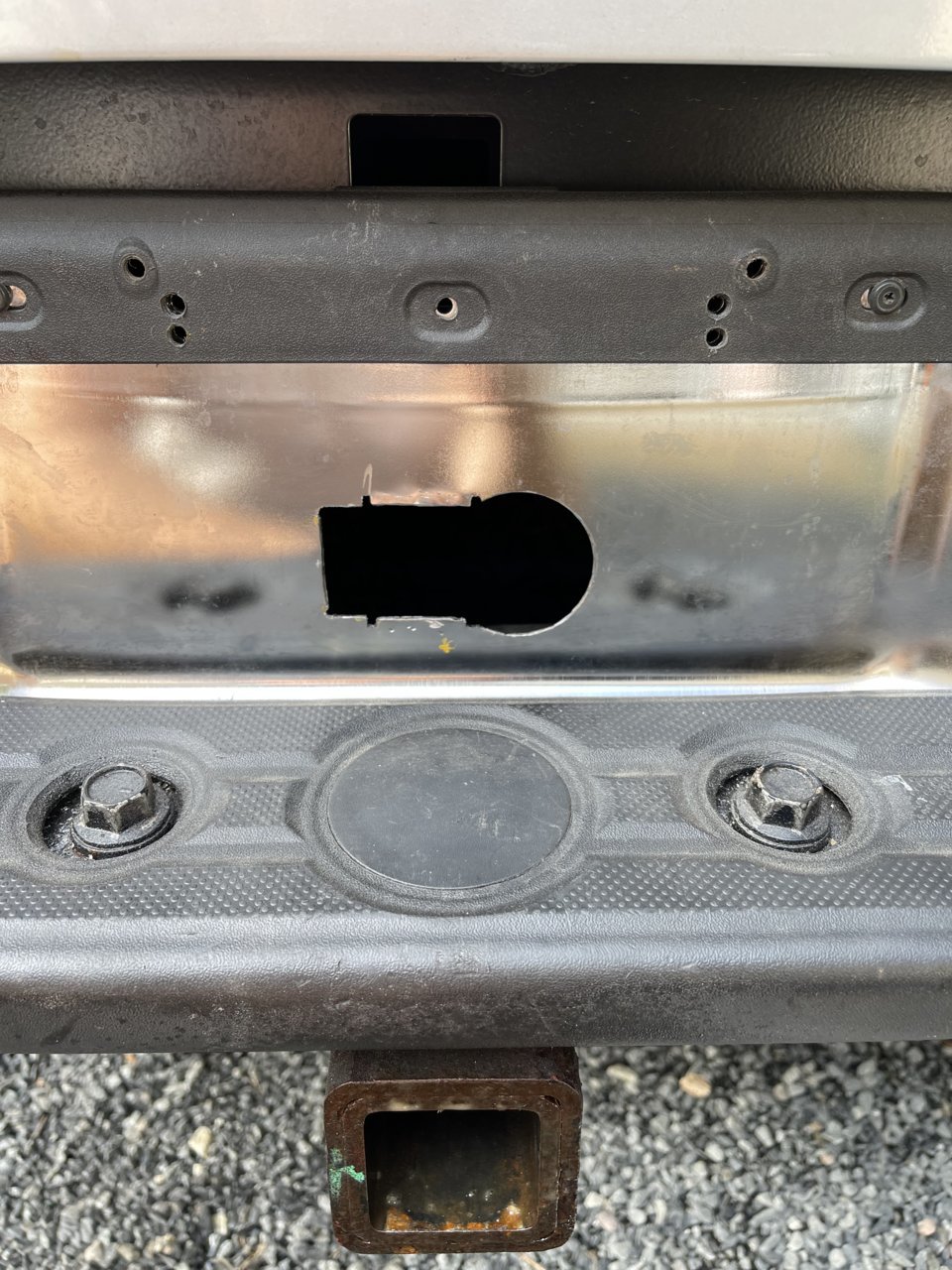

    Question for AVIOTREN on the 7:4 pin plug behind the flip up license place. What size hole saw worked best for it? Did it sit tight once snapped in or did you have to put a plate behind it for more bite?
  14. Sep 5, 2025 at 11:56 AM
    #74
    AVIOTREN
    AVIOTREN Member
    May 12, 2019
    #293067
    16
    AL
    Cape Cod
    2008 Access TRD Off Road Rugged Trail Silver Streak Mica
    i don't remember what size i used but the rectangular portion of the opening is the part that locks into the metal clip in the 7/4 plug. I just cut it to be too be slightly too small and opened it up about a little bit at a time till it fit snug.
