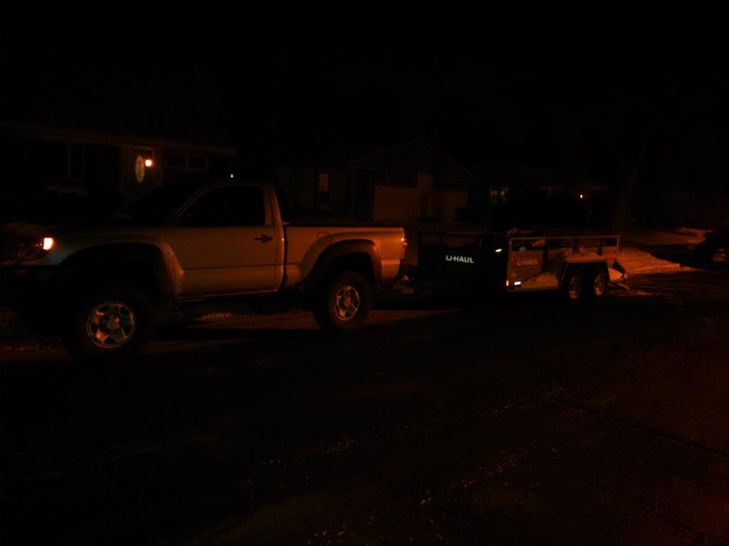

    I just bought a used 8x8 snowmobile trailer and a 2005 ski doo.....my trailer needs repairs though and I was itching to get the sled home so i rented a u-haul 6x12 with ramp. never expected a trailer that size to weigh 2,290 pounds! plus the 500+pounds of snowmobile once I picked it up.I was worried about towing something this big with my 2.7 reg cab 4x but I took it cautiously while still hitting speed limits ( up to 55 ) and she handled it surprisingly well! The trailer is equipped with brakes so that helps a lot, and I downshift always to be as light on my brakes as possible on the truck. 5th gear is a definite no-no though, she falls flat on her face with no more pull. I will not tow another trailer this size, weight etc. again unless absolute necessity but she does have it in her to handle it!

    It's new......mods starting soon. Removed step bars so far. lol
    crappy night picture but you can see it

    Dual axle ... explains the weight.

    yeah and its all heavy gauge steel construction.....its a rental unit so they make them to get abused
