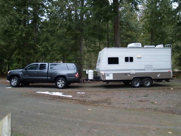

    How well do the tacomas tow?
    i am looking ot get a 19' light trailer, i think the weight s about 3700 +- dry ! will my 09 tacoma 4.0 v6 tow this with out the trany falling out ! i have the factory hitch IV , says total towing weight is 6500 !
    any input on towing would be great and i have read some of the posts others left !
    a simple yes it will tow with no major issues will do thanks

    There's a Tacoma Towing Guide under mods and tutorials.
    But, for a more simple personal answer, a 19' trailer is pretty big for a Tacoma especially if it weighs 3400 lbs alone. That gives you only 3100 lbs to work with which could add up very fast.
    Sounds like a bad ass trailer though.

    No problem towing that. There are plenty of people out there that will tell you that you NEED a 3/4 ton diesel truck for towing anything - ignore them!

    As long as you don't exceed 6500lbs and don't exceed the GCVWR - which I think is something like 11,100lbs. Trailer brakes are a HUGE benefit and I'd recommend making sure the trailer has them. Also - a weight distributing hitch which will help the truck handle the load better.

    i think i have the towing package, its the 4.0 sport came with the hitch, and yea its a camper trailer, all aluminum, starcraft i think, im looking, but its about 3800 dry weight!
    thanks for the input!

    19', western washington state, lots of hills, no problems. 3500 weight empty

    My travel trailer is 3750 wet and loaded, and I have no problems even up into the pocono mountains in Pennsylvania, the only time I even know it is back there is when I look in the mirrors, or am climbing those mountains.
    I have the 4.0L and the 6-speed manual. You will absolutely need a Weight Distribution hitch, some form of sway control (I am partial to the dual-cam type) and an electric brake controller, as a travel trailer of that weight will have brakes.
    You'll be fine, just keep it out of overdrive, unless you are watching for the transmission hunting and you'll have no tranny issues to worry about.

    nice looking rig. with all the correct towing accessories, the taco should be able to handle it :D
