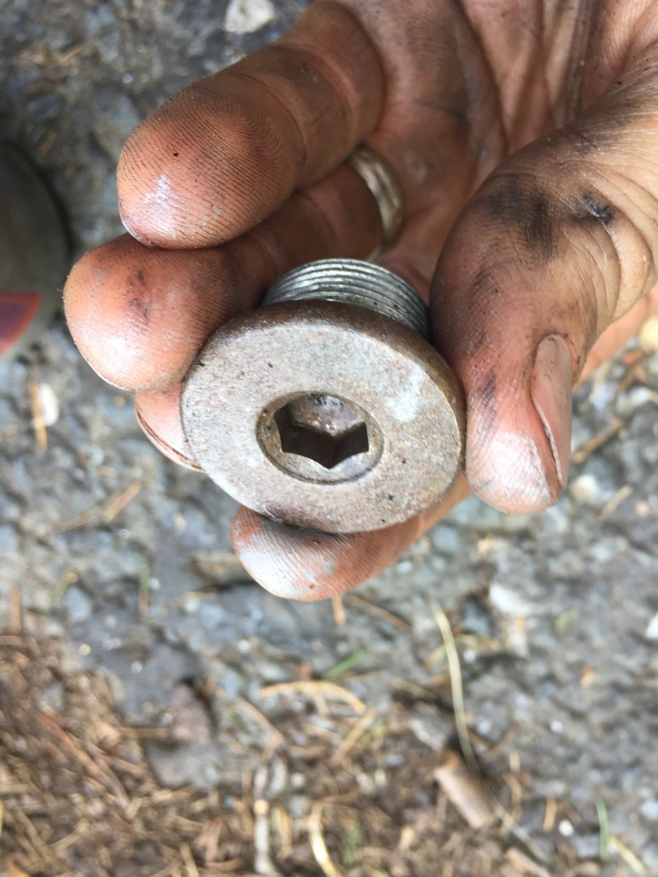

    Just did this yesterday, so I can probably be of some assistance.
    I used redline MT-90ns for the transmission, same for the transfer case. The rear differential just used cheapo Walmart full syn 75w-90. Was planning on using the rest of the redline for the front differential, but I couldn’t get those pesky bolts off. Going to get more tools and attempt again next weekend..

    Be careful removing the front diff drain plug. Very common to strip these! Make sure tool is fully inserted before applying force. Clean out the hex hole real good. I think it’s a 10mm hex socket.

    Can confirm, it is a 10mm hex wrench.
    I need to buy a socket insert (or 2 ft of lead pipe) as my 10mm hex wrench doesn’t give me enough torque to take off the bolts that Sasquatch put back on when he drained my front diff last.

    I do the same - Supertech in the diffs and MT90 in the transmission. Change every 30K.
    I like to use penetrating lube and shock the threads with a ball-peen hammer before I remove it. An impact driver comes in real handy on these as well.

    Put some penetrating oil on it then go at it with a breaker bar. No sweat
    Oh and always take off the fill plug first ALWAYS

    I always put Teflon tape on my plugs when I re-install them. I've never had a problem removing them later after doing this. Also, on the drain plug in the tranny, put some Teflon tape on it and DON'T over tighten it. They're easy to strip out since the case is aluminum.
