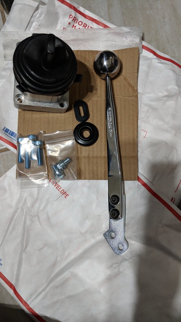

    I've actually been a fan of your detailed posts/work too been reading a lot of your stuff lately and actually ended up getting the Core Hurst Shor Shifter, it's going in today! :thumbsup:
