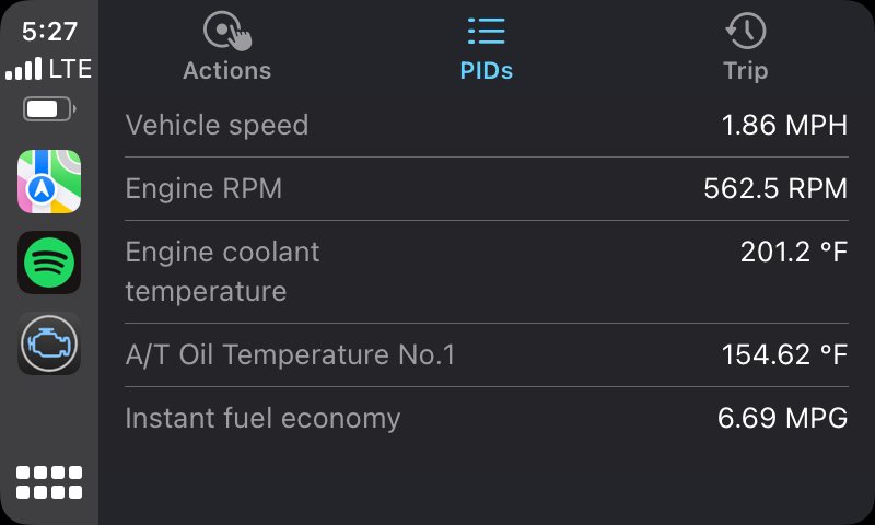

    With the OBD Fusion app, you can use Carplay to connect to your OBD II reader where you can display PIDs on your head unit.
