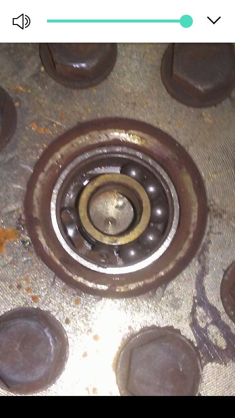

    Here is the problem, thanks for your help.

    Was that replaced 10K miles ago?
    If so what brand?
    Only asking for posterity's sake, we need to make informed decisions in the future.
    Many of us have the clutch bound to be coming up in the near future. 200K miles is asking a lot from stock components, ANY of them.

    I'll be ....!
    Anything you can think of about install gone wrong?
    I will say thank goodness that seems rare.

    No nothing I can see, even Toyota has bad parts sometimes, lol.

    wow.... that's a one in a million thing. I wonder where the missing ball bearings went?

    when the bearing comes out tell us who the manufacturer is please, I am curious if it is a Japaneese bearing, a Korean bearing or a chineese bearing. In addition, I think that that bearing should be shielded on bolt sides... that is a pretty harsh environment, clutch dust and heat, to not have a double shielded bearing in there to keep the dirt out and the grease in.

    As I stated above it is a Toyota bearing and it was shielded on both side.

    It's not Toyota. Prob. a Koyo if you bought from the dealer. Should say on the shielding.

    Nothing on the bearing, whats left of it

    Doesn't matter much, it;s rare to see.
