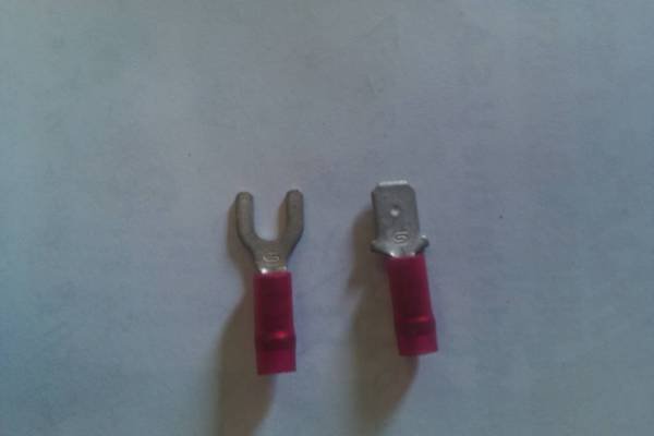

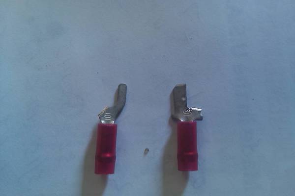

    Easy enough to make. Find a piece of short wire like in the video, then go to a local auto parts store and find the right size terminals to crimp on the ends. If you cant find the right ones, you can take a standard blade terminal and cut it in half. That is about the width of the DLC terminal.

    Here, I just took two different types of terminals and made what you need. Make sure to use the red ones, not the blue or yellow as they are too thick and will damage your DLC terminals.

    Personally I suggest against using a paperclip, as they tend to be thicker than a standard DLC terminal. The thought is a good idea, the application can have issues.
