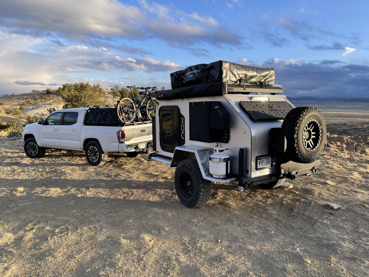

    In the Colorado Mountains in the dead of winter I have seen trans temps peak around 224 on my rig in S3 w/ ~3000 lbs behind me going through headwinds gusting to 50+ mph. I'm in a 2021 DCSB TRD Sport Auto so my rig comes with the thermostat set to 190 and the ambient temps were in the low single digits as I went from Denver through the mountains to Salida and both TF1 and TF 2 sat at 190 - 195 the whole way. I'm not sure if the '19 TRDs have the same thermostat settings but it sounds like you are doing everything right. As long as you are not sustaining those temperatures for very long you should be good.
    I believe the towing bible linked in my build thread towing post has some information about temperatures and how they effect the life of ATF. I don't like temps in the 190s, I like temps in the 170s so I am going to add an external cooler and fan pack in the next month or two. I plan on pinning the trans open and running a Setrab 900 series cooler in series with the factory hardware for towing and long, slow climbs while wheeling in the desert where trans temps can soar to 240+
    Driving in S5 is not bad, I do it all the time and have no issues. I spend most of my time in S4 though and had to keep it in S4 across I-80 going 70-75 Mph in a strong headwind because the trans was hunting for gears. No issues whatsoever. Just watch your TF2 temp VERY CLOSELY when in S5 or S6. When you start to see the temps rapidly climb it is time to downshift into S4 and you'll see temps rapidly fall.
    Edit: typo
    Edit 2: added last paragraph
    Edit 3: added a pic so you can see what I tow - others tow much heavier than I do successfully
