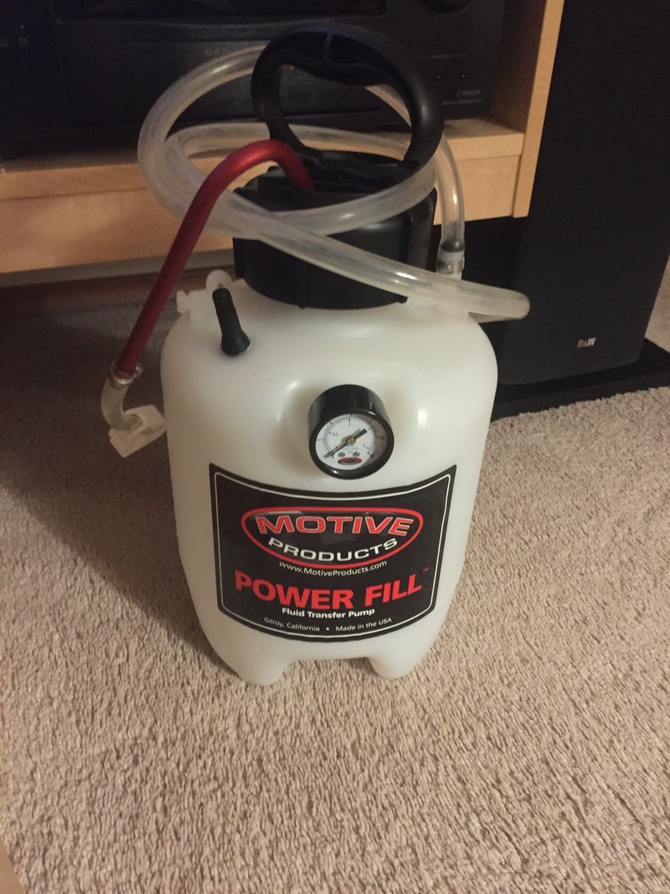

    Just picked this up for my next Dif x 2 & TC and Transmission oil changes....should save a lot of time! Used the small hand transfer pump last time...

    How much was that? I’ve thought about trying to convert a garden sprayer.

    Time is money $63.00 USD or $82.00 CND .... thought about using a garden sprayer myself but because most of them are taller than this pump it would be easier as it will slide right under my truck....

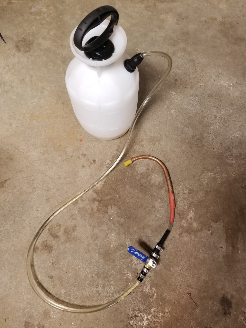

    Here's the one I made from a small garden sprayer. Used a piece of soft copper I had at the end to hang into the fill hole.

  20. Jan 9, 2020 at 10:06 PM
    #40
    ucdbiendog
    ucdbiendog Well-Known Member
    Dec 12, 2017
    #238320
    874
    Reno, NV
    2014 DCSB TRD OR
    Bilstein 6112 + 5160 + Dakar MD, Stubbs HD-SKO sliders, BAMF skids, BAMF front bumper, Relentless Rear
    That’s fantastic. Are you able to get the full fill without having to re-pump?
