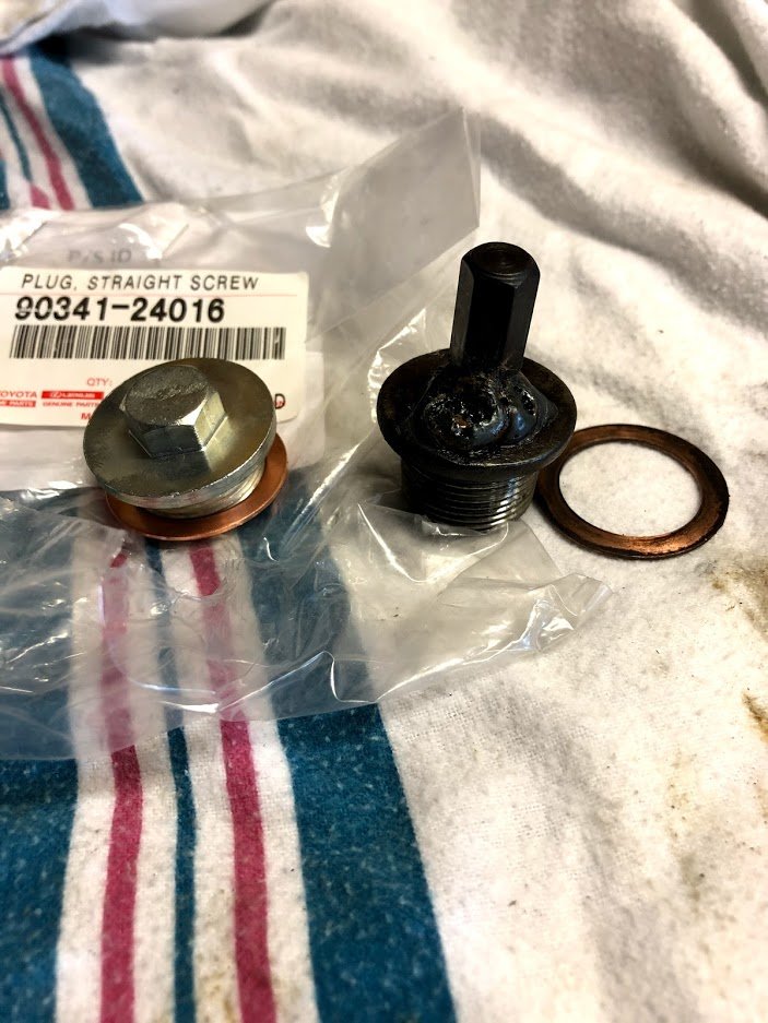

    PB blaster won't do a thing to loosen the drain bolt, they are seals. If PB Baster could get "in" then your oil is getting "out"
    Clean the bolt for sure, but I really don't think penetrating oil helps with any of the oil drain bolts.
    just my opinion :crapstorm:
    Heat on the other hand.... that works wonders! same with welding a bolt / allen sockt to the stripped out hex. That's what I had to do. ( why could they not just make it a square hole to accept a 1/2" drive, or 3/8" drive? would have been so much easier )
    that or you could buy the Lexus GS430 drain bolt that has a 14mm head on it. That's what I had to end up doing after I stripped min out.
    0QGiNpvtSiiedBUddSP9htxXl5yHxfeYwtDFDSp0_1fe7a4e082407531800844240ba77aad14ffdaac.jpg
