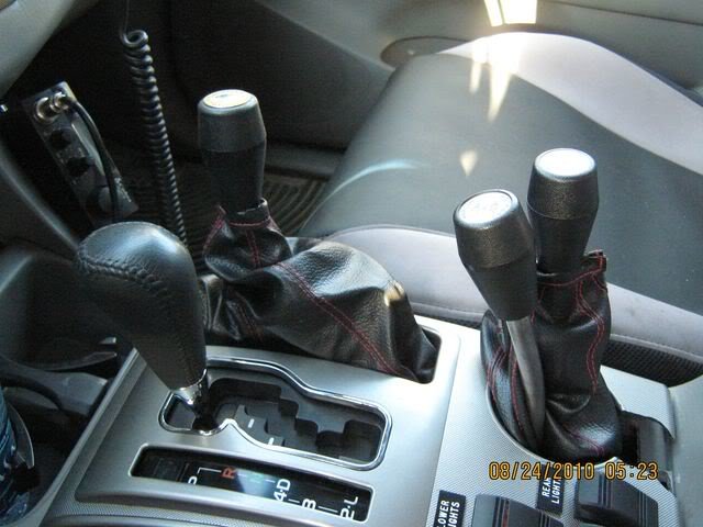

    Not when you do a conversion to a Manual T case! [​IMG]
