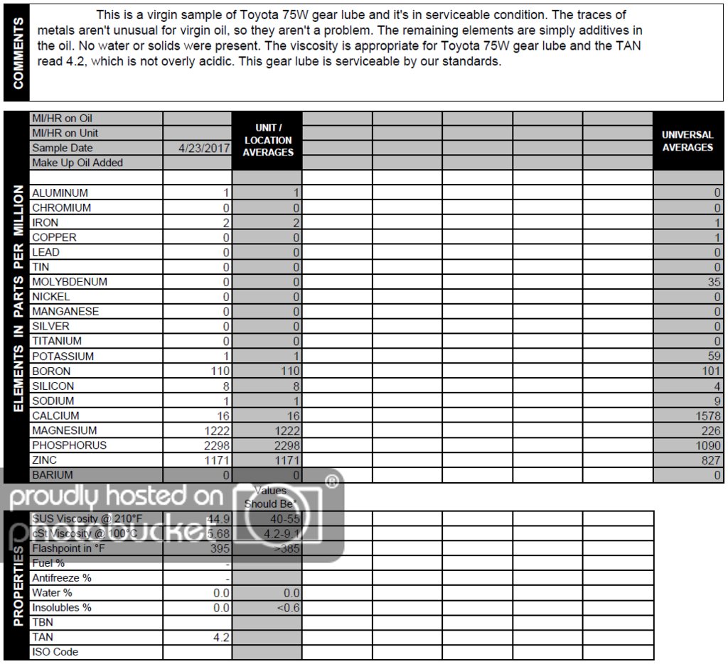

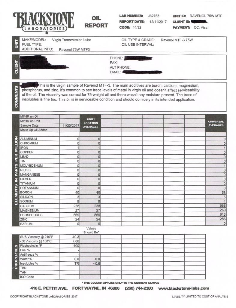

    The closest thing available is Ravenol MTF-3 75W SAE.
    VOAs show it's somewhat lacking in the additive package, compared to Toyota LF.
    That said, people have been using it with no complaints.
