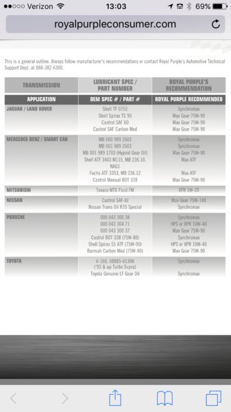

    Royal Purples Synchromax is a direct replacement equivalent for Toyota LF transfer case fluid. There is a concern using any other type that may have high phosphate levels will cause damage to the soft metal bushings.
    I changed out my fluid after the first 5K with the Synchromax and have put on another 13K driving across the country and in all types of conditions from blizzards in Northeast to high heat in low desert of California. No issues.
    I also went to a dealership in the northeast and asked for LF transfer case fluid, the parts guy treated me like an idiot and told me they use 90W gear oil from a drum. Maybe he was new.

    As far as I know - there are NO legit replacements for Toyota's 75W LF fluid. There's some discussion here: https://www.tacomaworld.com/threads...-6mt-fluid-change.481719/page-3#post-14712154 (posts 43-45).
    I've heard, anecdotally, the same thing about Royal Purple but I have yet to see any documentation from them regarding equivalence. I'd change my tune if I saw the documentation but I don't think it exists.

    It on their website and I sent a question to them on line and they answered it for all to read in the questions section of the same website.

    I had my hopes up when I saw the royal purple chart posted. But that chart says toyota genuine LF gear oil. Toyota is calling for Toyota Genuine Transfer gear oil LF. It specifically says "transfer". In the toyota parts manuals these are two different part numbers.
