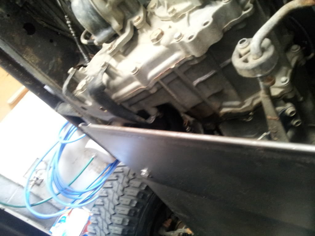

    So I've been looking around for ideas for a transfer case skid with my current skid plate setup. My current setup, made by Ryan(isu2014), covers part of the transfer case. Here is a link to the current group buy for these skids. I've been looking at the Trail gear one and Skid Row's transfer case skid but I also ran across all pro's transfer case skid. I don't know that the skid would offer much real protection other than scrapes like the stock skid does with the way it's designed. I'm not a fan of all pro stuff but I figured I'd listen to other people's input on the skid. Anyone run the all pro skid? How do you like it? How has it held up? Any other vendors that sell transfer case skids? I'm also thinking extra protection with my current setup may not be necessary. Any thoughts are welcome.
    My current setup:

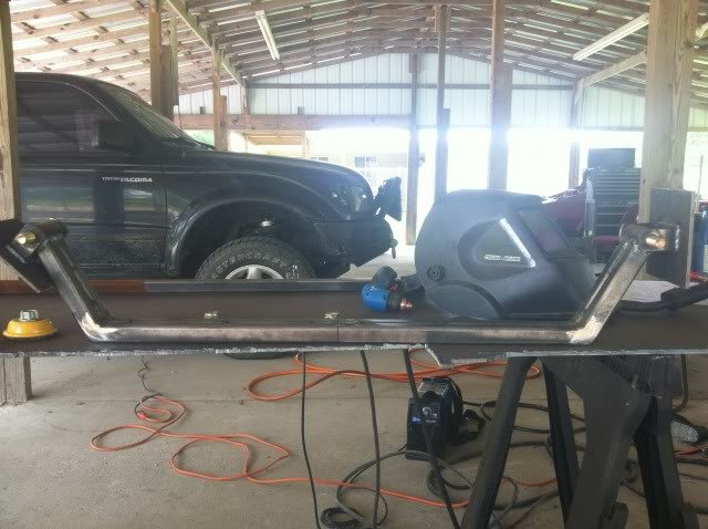

    I made my own. I made a crossmember for the rear and then attached the plate to it and the factory crossmember. Then I welded square tubing to the plate to beef it up a little.

    That looks good! I think a custom transfer case skid will be the way for me to go.
