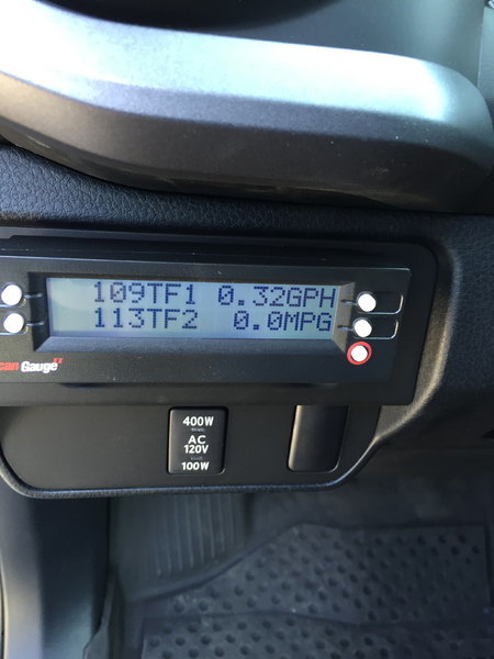

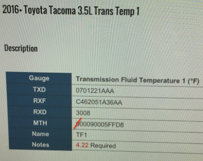

    I finally checked mine myself (2016 Taco, build date 7/16 Texas), but did it the ‘easy’ way – bought the “Scan Gauge”, although it cost $160 it’s worth it to have it if only as a trans temp gauge for towing (NOTE – if you buy one of these you need to ‘code’ it for the trans temps, easy to do just follow the instructions and get the ‘codes’ on the web, but one code, the “MTH” is one digit too many, when you enter it, just leave off the first 0 in the sequence, see image, i put a red line thru the first 0 - hope i posted this correctly, sorry i am new to the forum).
    Important for those not transmission savvy - the "AC60E_ AUTOMATIC_TRANSMISSION FLUID_ ADJUSTMENT_2016-12.pdf" does not say this, but BE SURE THE ENGINE IS RUNNING (in park) WHEN YOU PULL THE TRANSMISSION OVERFLOW PLUG! And, as other threads mentioned, watch for that damn heat shield, it got me - was wondering where the trans fluid was coming from when i was unscrewing the plug, only to find out it was my own blood - i failed to pay attention, so easy to cut the back of your hand it's ridiculous.
    The Adjustment guide also does not mention you need a 24mm socket to remove the overflow plug (knowing this ahead of time will keep you from putting your hand up there to check a sizes until you find one), and BTW if you don't have a 24mm, a 15/16 will work just fine.
    The Scan Gauge gives you two trans temps (TF1 and TF2) - haven't figured out what areas of the trans they are measuring, but when i checked mine i waited until both temps were at minimum range (like 95 & 101), by the time i was done it heated up to max range (see image below) - perfect timing. Oh - and a great place to put the gauge, right in front of that weird useless cavity to the left of steering wheel (and then you have a secret stash box behind it :))
    Oh - My trans was not low (2016 Taco 4x4 Offroad, build date 7/16 Texas, with a tow package), I pumped in about 3 ounces before it started coming out the overflow, then took about a minute to come to a drip-drip-drip. So I am very happy and relieved to know the trans is full without relying on trusting a service tech.

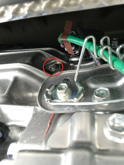

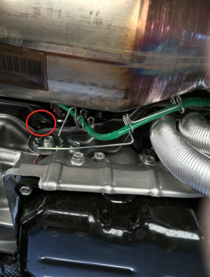

    Also thought i should mention, especially those with 4x4 (where trans looks a little different than image in adjustment guide) - here are some picts of the refill plug location (crawl under passenger side):
    gearcruncher[OP] likes this.
