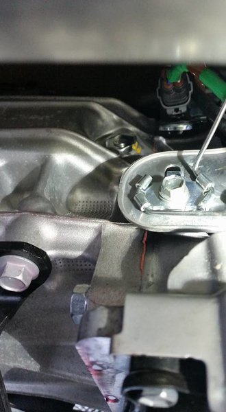

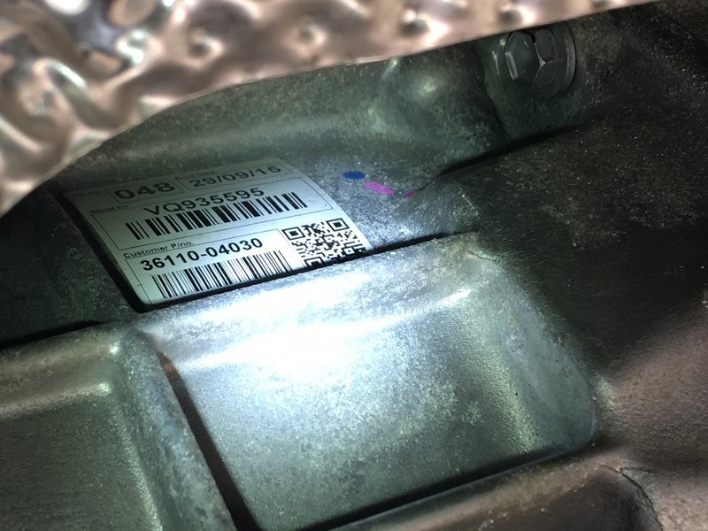

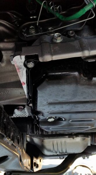

    So after my 2nd attempt, I finally had my fluid checked yesterday by my local dealer. I post this in the other thread but no one responded but one person, and I want to get more opinion.
    Original post:
    Shop foreman who worked on my truck said the transmission was half a quart low.
    Like some have done, they put some kind of markings on the transmission bolt just to be sure it was properly checked. So I went ahead and made a yellow marking on the bolt. Got back home and check underneath the transmission and it was evident that there was some transmission oil by the pan (shop foreman was lazy enough not to wipe it) :mad:
    Now checking the bolt, it look like it hasn't been touched! What ya think? Did I marked the wrong bolt? I will be talking to the service manager about this but just want make sure I didn't mark the wrong bolt and look stupid...

    It's hard to see but that looks like the wrong bolt. The overflow is a hex or Allen wrench style.

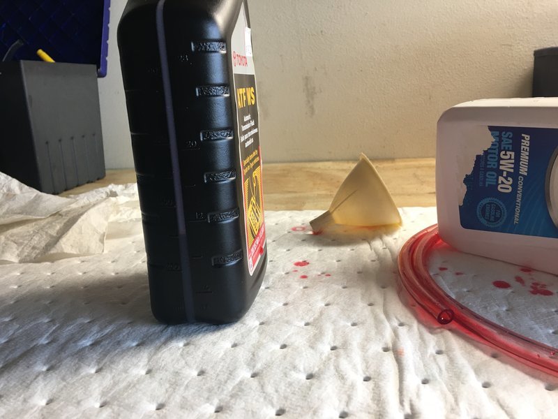

    Just casted my vote, was roughly 3/4 qt low (20oz) pinned check method. 16 trd or Baja Mexico 12/15 build date. Pic of what was left in jug after finished and sticker on side of trans for reference.IMG_0969.jpgIMG_0970.jpg
