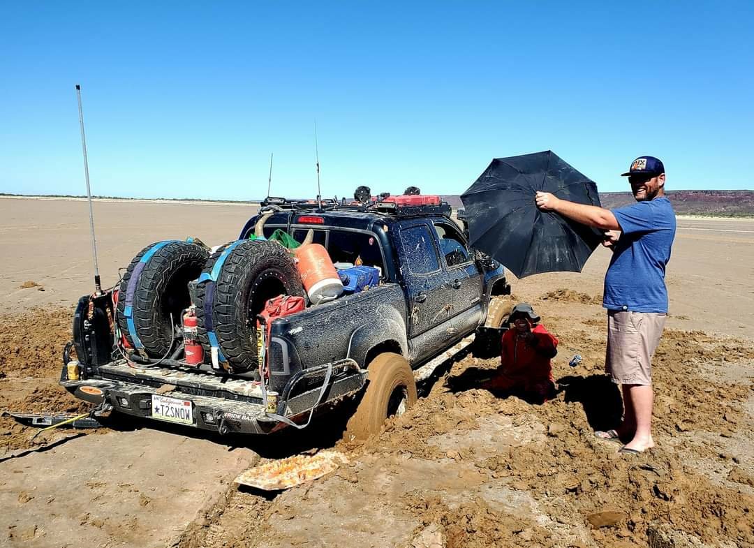

    Hello transmission problems. One thing I have not read in here is how to know when the transmission is toast. I recently baked mine in skids filed with mud for several hundred miles. Now I can only drive it for a little bit. Once she warms up it will not go into 1st gear or if challlenged with a hill it stops. Had a major mud episode and belive it is now toast at 165000. I have never serviced this and that has proven to be bad for sure. Did a small flush in the autozone parking lot in baja to get here going again for a 100mile but then as soon as I come to a stop she quits again. I thinks she is done and do not believe a rebuild save it. I will be dropping the pan later to take a look and see the damage. She starts right up at this point and I have moved her around the yard but know that if I was to drive it it would just quit again. Just looking to get some more ideas.

    That sucks . Post some pics of the fluid and pan magnets when you do it :thumbsup:

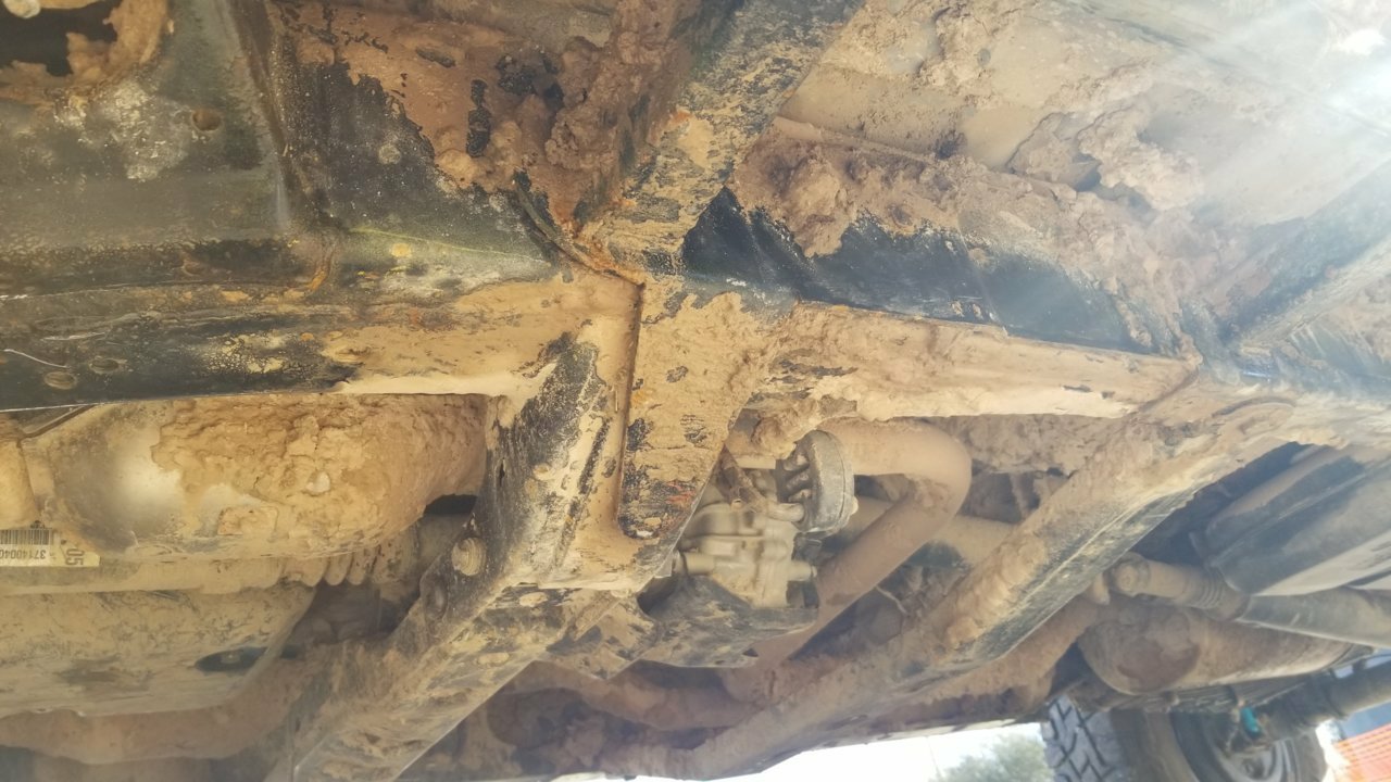

    Don't do this. This is after we removed skids and about 200lbs of mud that the transmission pan was baking in!
