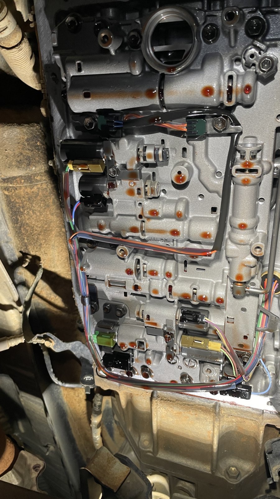

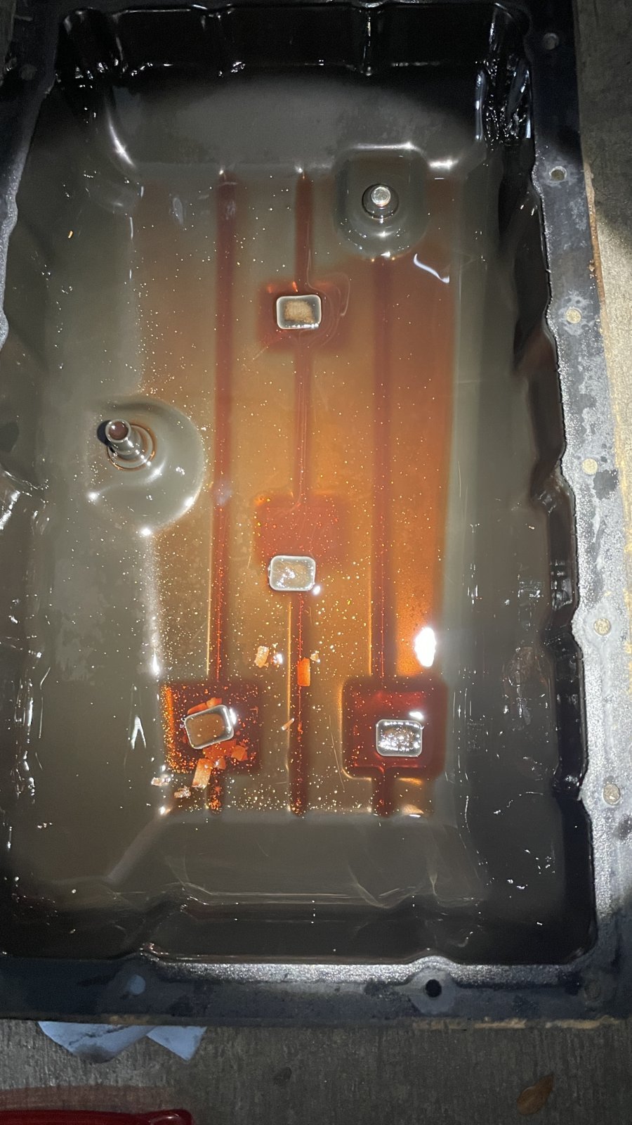

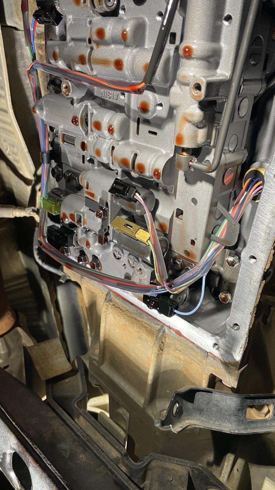

    Here’s the update:
    Drained the fluid and caught it to send it off to Blackstone; dropped the pan to Ohm out the SLU solenoid, it is indeed bad (reading 6.1 Ohms instead of 5-5.6). Wiring looks good and bottom of the valve body looks good. However there are some non metallic flakes in the bottom of the pan. Doesn’t look like clutch material to me but perhaps something that’s come out of the new torque converter? Have you ever seen flakes like that?
    once the new solenoid arrives from Toyota I’ll button the pan back up and refill with Valvoline Maxlife and Lubeguard platinum and work on starting the ATF cooler setup. But my boss and I were thinking it might be smart to drop the valve body and take it apart to clean it out? What is your take on it?

    Looks like aluminum to me .
    If the flakes were steel , they would stuck to your magnets .
    I agree that dropping the valve body will help .
    Have a Sonnax zip kit ready to go

    thats what I'll do then, any tips on getting the connectors out of the solenoids? Had a difficult time getting the SLU connector off
    Secondly what do you think about the flake looking things in the bottom left? Haven't touched them yet to see what they're made out of

    That's a lot of metal in your pan .
    I am thinking rebuild if you plan to keep it .
