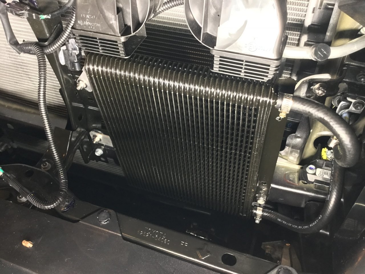

    Instead of a Hayden cooler, of which I’ve installed a few, I’d recommend purchasing a Tru-Cool stacked plate cooler manufactured by Long.
    Long also makes B&M coolers which are exactly the same as Tru-Cool, but the B&M coolers just cost more. They are the exact same product.
    The Tru-Cool stacked plate coolers may cost just a bit more, but they are perhaps somewhat more durable than the tube and fin or plate and fin style Hayden coolers, and there are no delicate fins to bend during installation and/or when cleaning off mud, dirt or insects.
    LPD4589 in the picture. An LPD4590 would also easily fit in the space if you want to go with the largest cooling capability.

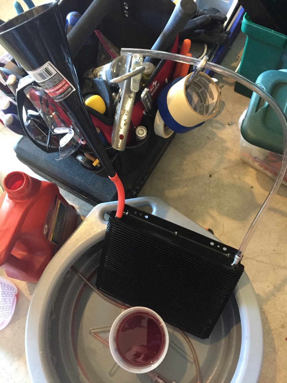

    8A094207-6E34-4C5A-8286-7ABFA63E1465.jpg F89AB51F-B997-41A2-8B5C-44768DA6CAD5.jpg
    Adding fluid and measuring volume.

    I installed the 4590 on my truck last year. I wanted to know the actual amount of fluid it held so I called Long and asked them. The tech I talked to said it holds .84 quarts. So with the small amount of fluid loss when I took the factory cooler off and the .84 in the new cooler it took right at a quart to top it off.

    Its not necessary. Just fill the cooler with transmission fluid before installing the lines. If you do you will notice VERY little transmission fluid actually goes inside the cooler. 1/8 of a quart or so. What I did was installed the cooler, took the top of one of the lines and filled the cooler. Again very little fluid went inside and I just connected all the lines and was good to go. Never checked the fluid afterwards because it was not necessary to do so.
