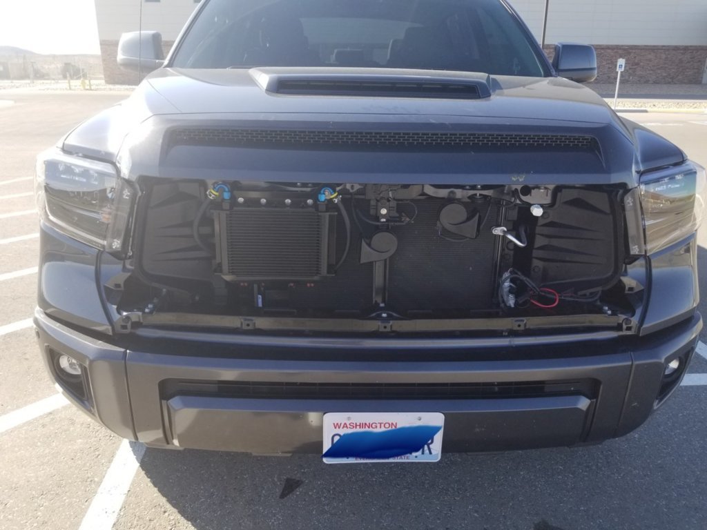

    Hey guys, I sold my Tacoma over a year ago and bought a 2019 Tundra. After I bought it I realized it did not have a transmission cooler even though the window sticker said it did. Long story short Toyota removed the transmission cooler out of all 2019+ Tundras without letting anyone know nor changing their window stickers. After seeing my transmission temperatures in the high 200's I developed a solution. I'm not sure if Toyota did the same thing here with the Tacoma but if there is enough interest I can build transmission cooler kits for you guys. Check out my thread on the Tundra forum below.

    2020 OR DCSB AT 4WD
    AN fittings, spring type hose clamps, hose supports with grommets - very clean install.
    chasenicholas93 [OP] likes this.

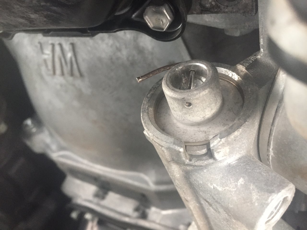

  20. Aug 1, 2020 at 7:51 PM
    #20
    OregontoBajaCA
    OregontoBajaCA Well-Known Member
    Dec 6, 2017
    #237812
    711
    2017DCLBOR
    And, you can keep that transmission mounted thermostat in the open position with a nail or small hitch pin, allowing you to run your transmission fluid temp far below 190 degrees by using a large exterior mounted fluid cooler if desired.
    That can’t be accomplished with only a cooler installed inside of the radiator.
