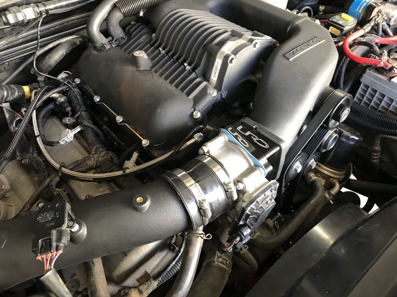

    What else have u done to get to 400 hp?

    Supercharger with a stock engine, cold air intake upgrade? Thats what I see with my limited knowledge. Doesn't look like a trd supercharger, magnuson?

    I don’t want to Takeover this guys thread but,
    Magnuson SC
    2.55” Pulley
    Upgraded injectors (I forget the size)
    7th inj
    DT Headers
    DT Y pipe
    URD 3” cat back
    70 MM TB
    UCON Stage 3 tune
    Exhaust Cam gears
    Fuel pump
    @Roostfactor pulley wrap kit
    High flow coolant pump
    Larger coolant reservoir
    IPT valve body
    I guess that’s it.
    400 HP is at the crank figured by MAF x something or other by Scott the UCON guy. That was a 40* F ambient morning.
