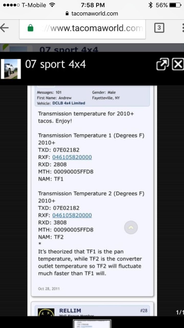

    How did you get TF1 and TF2? I believe my ScanGauge only has TFT.

    I found the codes on here somewhere a few years ago.
    I would go out and get them for you, but my truck is torn apart and the battery is out of it right now.

    Dang. Thanks though. I imagine TFT is the convertor since it fluctuates pretty frequently.

    The codes are on here somewhere. It’s pretty easy to add them once you find them.

    It’s a copy of a copy ..
    @KaPantsKey

    Thanks!

    It doesnt really matter what transmission temp sensor you guys choose to watch the transmission temperatures when using the scan guage or Ultra guage .
    It could be TF1 or TF2 .
    The trick to watching either sensor is making sure you are controlling your transmission cooling properly .
    175 degrees is ideal and this pretty much covers first / second / and third gen trucks .
