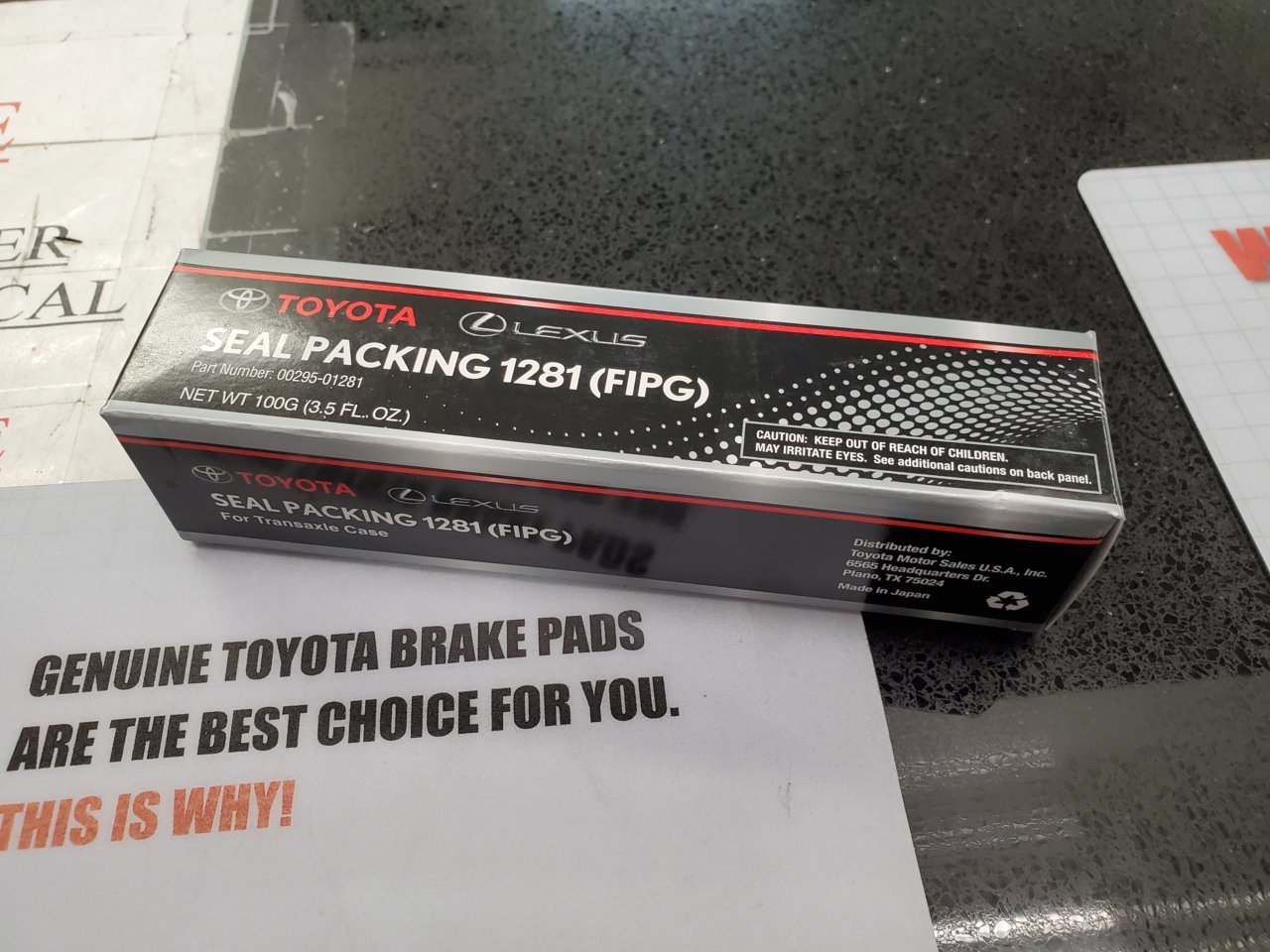

    Kwikvette
    Feb 27, 2019
    #284735
    81,121
    Fresno County
    4 run, 2 don't
    Drain and fill.
    Make sure you remove the pan, and go through the process of turning the vehicle on and shifting gears to get all the fluid out.
    Clean or replace the filter as well (it's just a screen, I ran brake cleaner through mine).
    I chose the Toyota FIPG to seal the pan back up because I developed a leak when I used the gasket, torqued to spec and all.
    Months and several wheeling mall crawling trips later, no leaks.
    Plain Jane Taco and nchiker1[OP] like this.

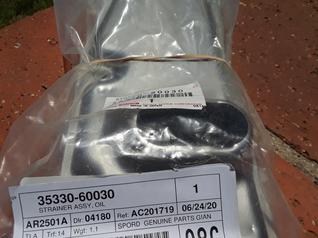

    I was going to post this on another thread but I'm going to do a atf change along with replacing the filter. Question is that I bought the filter from a OEM toyota parts discount and it came with some light dings. You think it's ok or should raise hell with them?
    There's a ding on the inlet hole lip.

    Kwikvette
    Feb 27, 2019
    #284735
    81,121
    Fresno County
    4 run, 2 don't
    Just roll it back out

    yodataco
    yodataco Well-Known Member
    Jun 9, 2013
    #105921
    716
    Alex
    Orange County, CA
    2000 4Runner
    MCM fab 3.5" LT front, OME 861 rear
    You mean just send it back or bend it back with pliers.

    Kwikvette
    Feb 27, 2019
    #284735
    81,121
    Fresno County
    4 run, 2 don't
    Replacing is absolutely the best way, but I needed to take care of my leak immediately.
