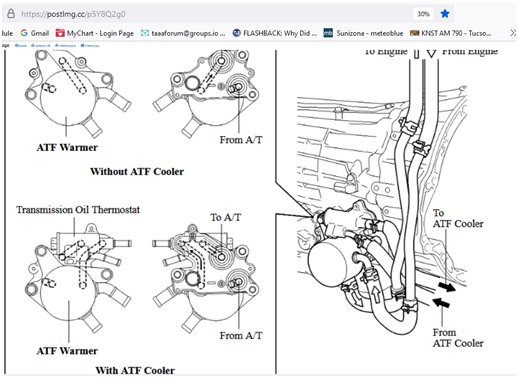

    I'm supposing you have a Thermostat on the pass side on the trans. Will you pin it open?
    Here's a flow picture for my 2021 TRD Sport, 6 cyl, 3.5L with towing pkg. Note the Trans fluid warmer PUCK, (heated from the engine) and the Trans Oil Thermostat. Note the out flow line (top connection to the radiator Trans oil Cooler) and return line (bottom).
  11. Aug 10, 2024 at 9:19 AM
    #191
    atc250r
    atc250r Recovering Ram Owner
    Sep 29, 2022
    #406909
    1,368
    John
    Orange County, NY
    2022 Tacoma SR5 - DC/LB
    LED interior, license plate, and fog lights. More to come.
    @Tacogent I'll probably not pin it and see what numbers it runs. Maybe next trip up I'll pin it.
  12. Aug 10, 2024 at 11:21 AM
    #192
    Tacogent
    Tacogent Well-Known Member
    Sep 17, 2020
    #341076
    118
    Nonw Stock
    Since you're running unpinned (normal), I expect that your pan temp TF1 will be about 185F- 195F - near engine coolant temp, pretty consistently when driving flat. ... and that torque con TF2 to be near that and to change upward with any uphill pulls ..
