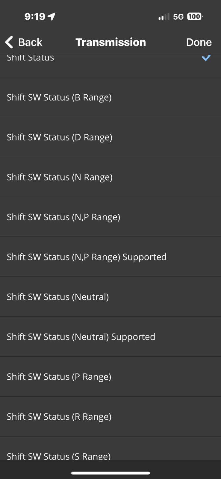

    Not to derail on the trans temp PIDs, but for those of you in a 21’ or newer, what are you using for the trans gear status? My OBD Fusion w/ Toyota pack for 2021 does not have the status of the shift selection. The Shift Status I have selected only shows 0 or 1. Any ideas or will I need to manually enter a PID for this to show what gear I’m in?
    ETA:
    For those interested and using the 2021 pack, Shift Status is correct for current gear. I needed to delete and re-do the gauge for it to function.

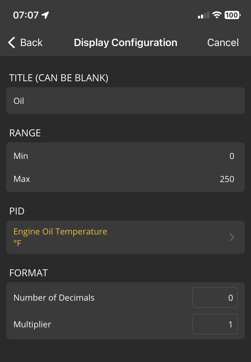

    Also at the risk of derailing things (hopefully not) is there an engine oil temp sensor that we can put in a PID for? Just adding that gauge didn't get any reading.

    Reading the huge thread on OBD Fusion, there is not a sensor that we can read through obd for oil temps. Most likely have to use Techstream or something similar.

    This may not be exactly helpful, but I'm using OBDLink on my iPhone and it has a PID for engine oil temp.

    That is a calculated value. There is no sensor for engine oil temperature. There is a low oil level sensor, and an on/off pressure sensor that is only useful for announcing with a red light that your engine is now toast.....
