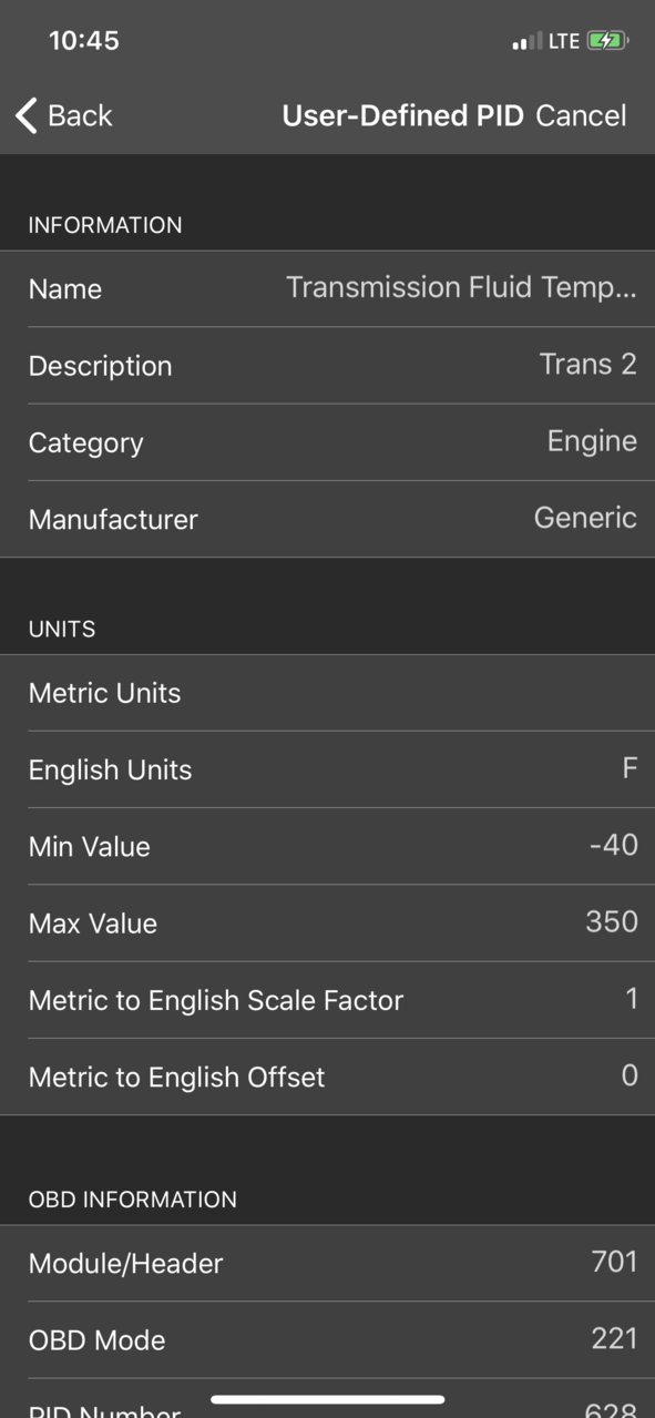

    I used torque app on 2nd gen I can confirm that it worked with 6s I had.
    I’m using iPhone X now, I don’t see it being an issue.
    Won’t be able to check today as I haven’t been able to get dongle back that I loaned to someone. Though I still think it’ll work

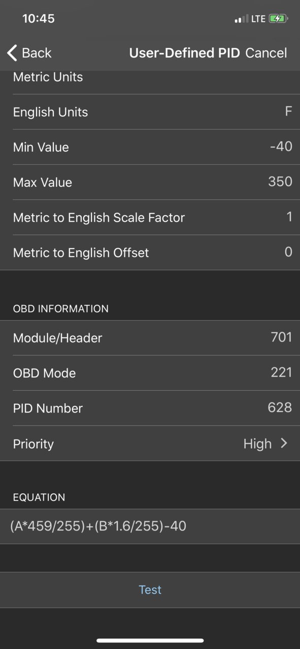

    So finally got it t work, I have iPhone X with OBD fusion app, works perfect

    Can you post a photo of the custom PID screen so I can see what the fields are called? Or just list the fields and what you entered, please. Would be helpful. I'll give you 10 Tacoma points. They can be traded for truck love but hold no other value

  10. Jan 3, 2018 at 10:48 AM
    #30
    Hank Heel
    Hank Heel Well-Known Member
    Sep 18, 2016
    #197637
    1,644
    WA

    Thank you! I will include this in the first post with a credit to you.
    I was wondering if they broke up the mode and PID like some other android apps

    Now with Apple Support! You will need a different OBD2 dongle because the Apple devices don't allow bluetooth connection to dongles like these. @Hank Heel has shown that OBD Fusion App from the Apple iTunes store allows the creation of custom PIDs. *I cannot say what values these entries default to, so I can not bold the ones which need to be changed*
    Name: Transmission Fluid Pan Temperature
    Description: TF1 (pan)
    Category: Engine
    Manufacturer: Generic
    Units
    Metric Units __
    English Units: F
    Min Value: -40
    Max Value: 350
    Metric to English Scale Factor: 1
    Metric to English offset: 0
    Unit Type: F
    OBD Information
    Module/Header: 701
    OBD Mode: 221
    PID Number: 627
    Priority: High
    Equation: (A*459/255)+(B*1.6/255)-40
    Name: Transmission Fluid Post-Converter Temperature
    Description: TF2 (conv)
    Category: Engine
    Units
    Metric Units __
    English Units: F
    Min Value: -40
    Max Value: 350
    Unit Type: F
    OBD Information
    Module/Header: 701
    OBD Mode: 221
    PID Number: 628
    Priority: High
    Please let me know if you get this working on any other iTunes app

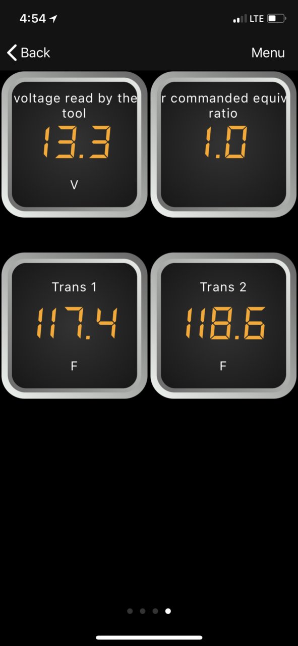

    I did obd fusion , iPhone 6, and a kewi3 reader. I paid the extra 10 bucks and the two trans temps are there, no custom pid needed.
    What is the location of each temp sensor? 1 and 2?

    TF1 is in the pan and TF2 is as oil exits the converter
    Can you check if the 10 dollar package has oil temps?

    Thanks I’ll check in the morning, it had it but I don’t know if it worked and gave the temp
