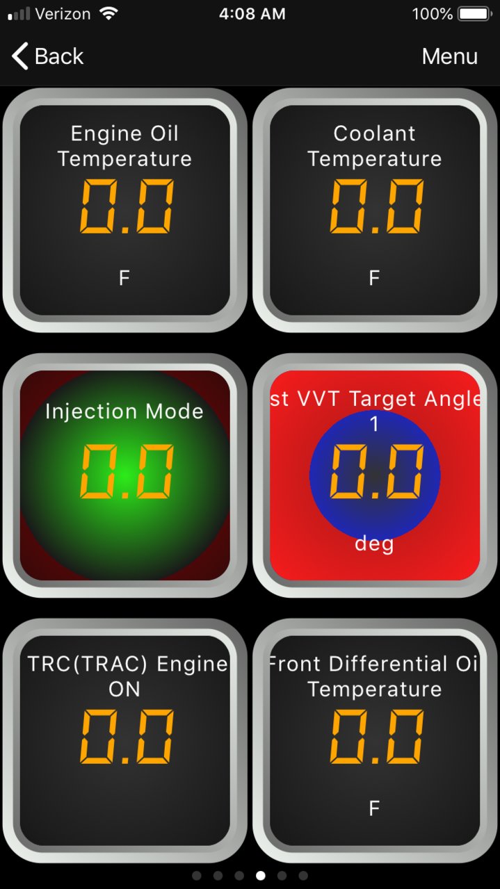

    There is a oil temp pid and it works. Top left.

    Do you have the Engine oil Temp PID that you could share with us?

    I don’t know how to share it. If you could tell me how to extract the information I will. I purchased the Toyota add on package in OBD fusion and it was in to engine section.

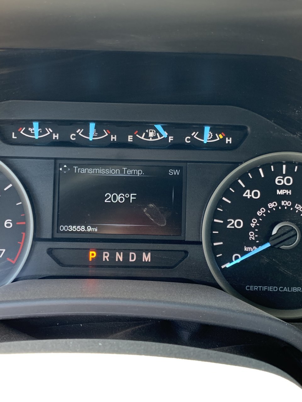

    So we have a 2019 Ford F-150 police responder as one of our work vehicles. I was playing around looking at the info it provides on the display. This was the transmission temp after a 30 minute drive, on 20 miles on the interstate and about 4 miles in town.
