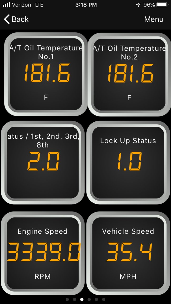

    What is everyone else getting for temps on there trans sensors, short trip after i put the blue tooth adapter on seems high

    What's your post? Is that in the pan?

    The trans Thermostat is pinned open.

    I was looking for the gear PID,
