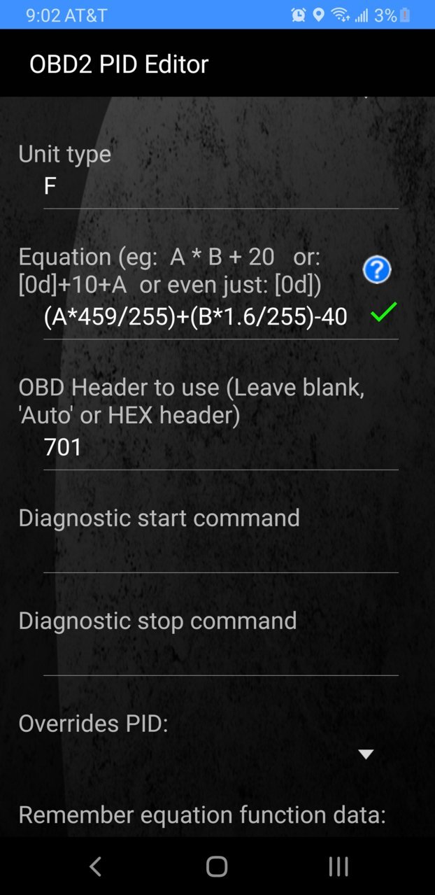

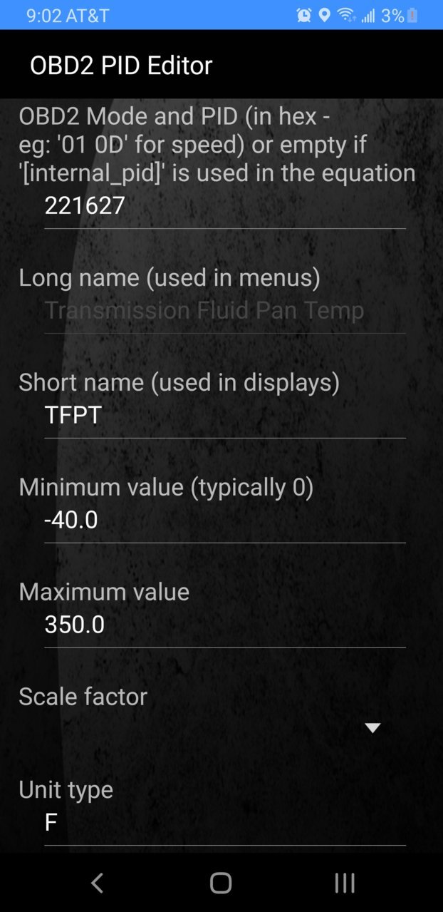

    Can you screen shot the PID set up screen for us?

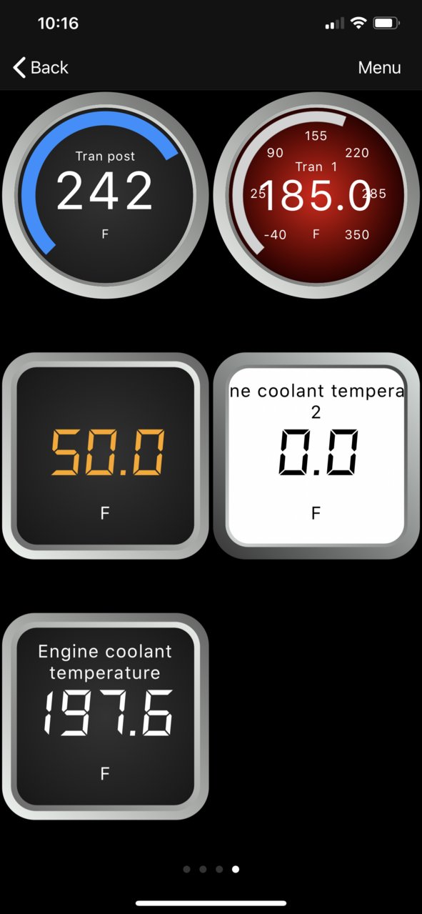

    I would suggest checking if the math is correctly entered if this in Torque app. 242 is far too hot for a short trip. The thermostat opens around 195 but it takes a while to get there

    I had a buddy do some research and figured it out with me. AT1 is pan and AT2 is torque converter. And yes, it acts just like you described. Got my fluid changed and added a cooler and the truck drives much smoother now. The fluid that came out was as black as coffee and not even as thick as water.

    The config is not working for me and I'm at a loss why. I do know that my ECU was updated as part of the recall for the emergency brake assistance sensor but that could be a stretch to think the PIDs changed for that.i get "No Data" when I test it. Screenshot_20200927-191455.jpg

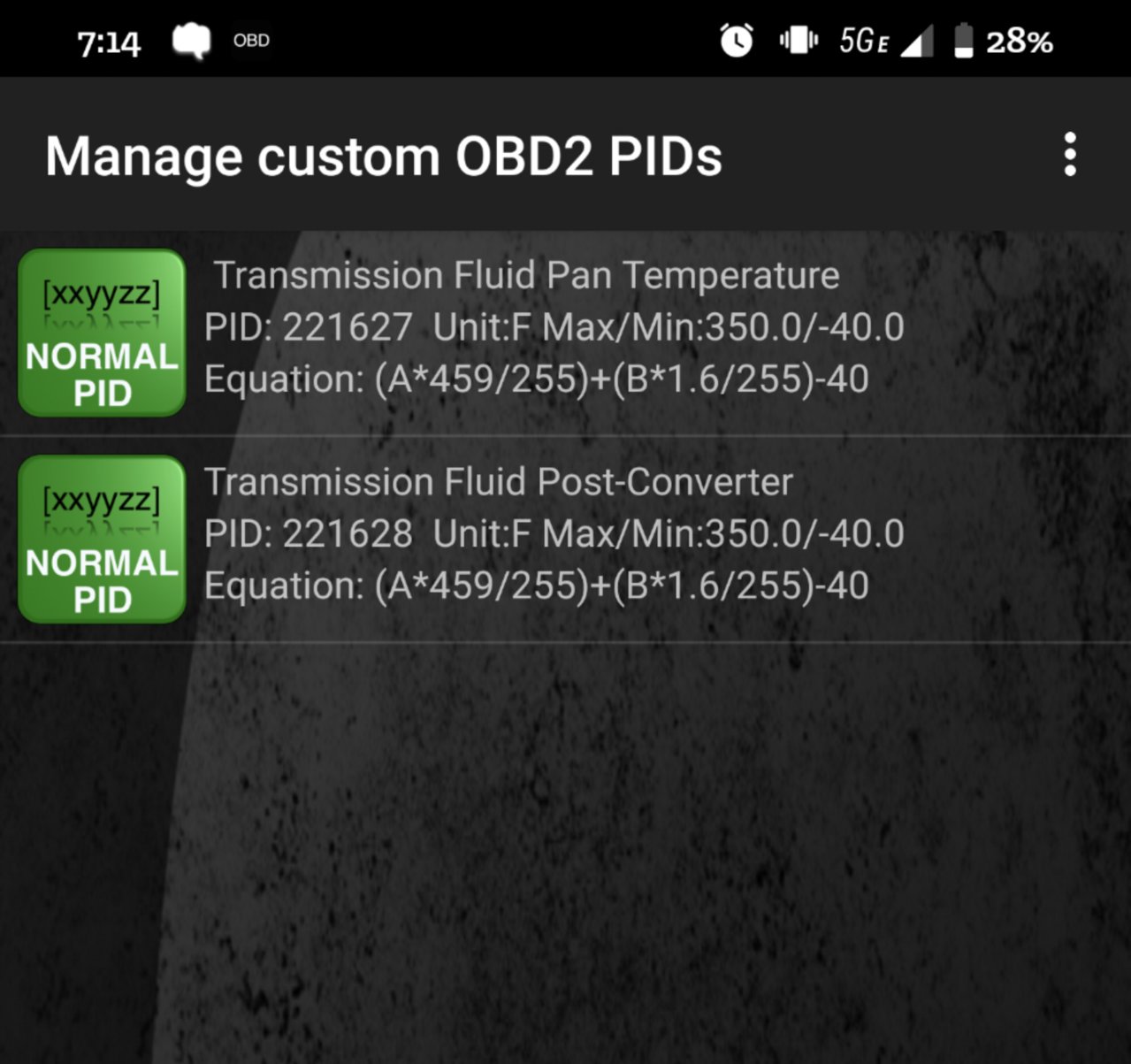

    Need help. I can't get this to work on my 2020 v6 auto.] Screenshot_20210415-210244_Torque.jpg Screenshot_20210415-210256_Torque.jpg

    Ditto for my 2021. I can get the post converter working just not the pan temp.
