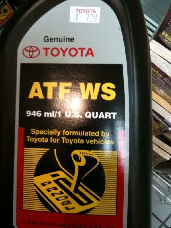

    Most use the Toyota WS as its the only stuff recommended by Toyota. Amsoil and Mobil both have ATF products that they claim are compatible with Toyota WS. I stick to WS however due to the fact that if anything should happen to the transmission Toyota will require the service records. I'd rather use the Toyota WS than risk having to pay $4000 for a new AT should something go wrong.

    When changing the automatic transmission fluid, use only "Toyota Genuine ATF Type WS" to aid in assuring optimum transmission performance.
