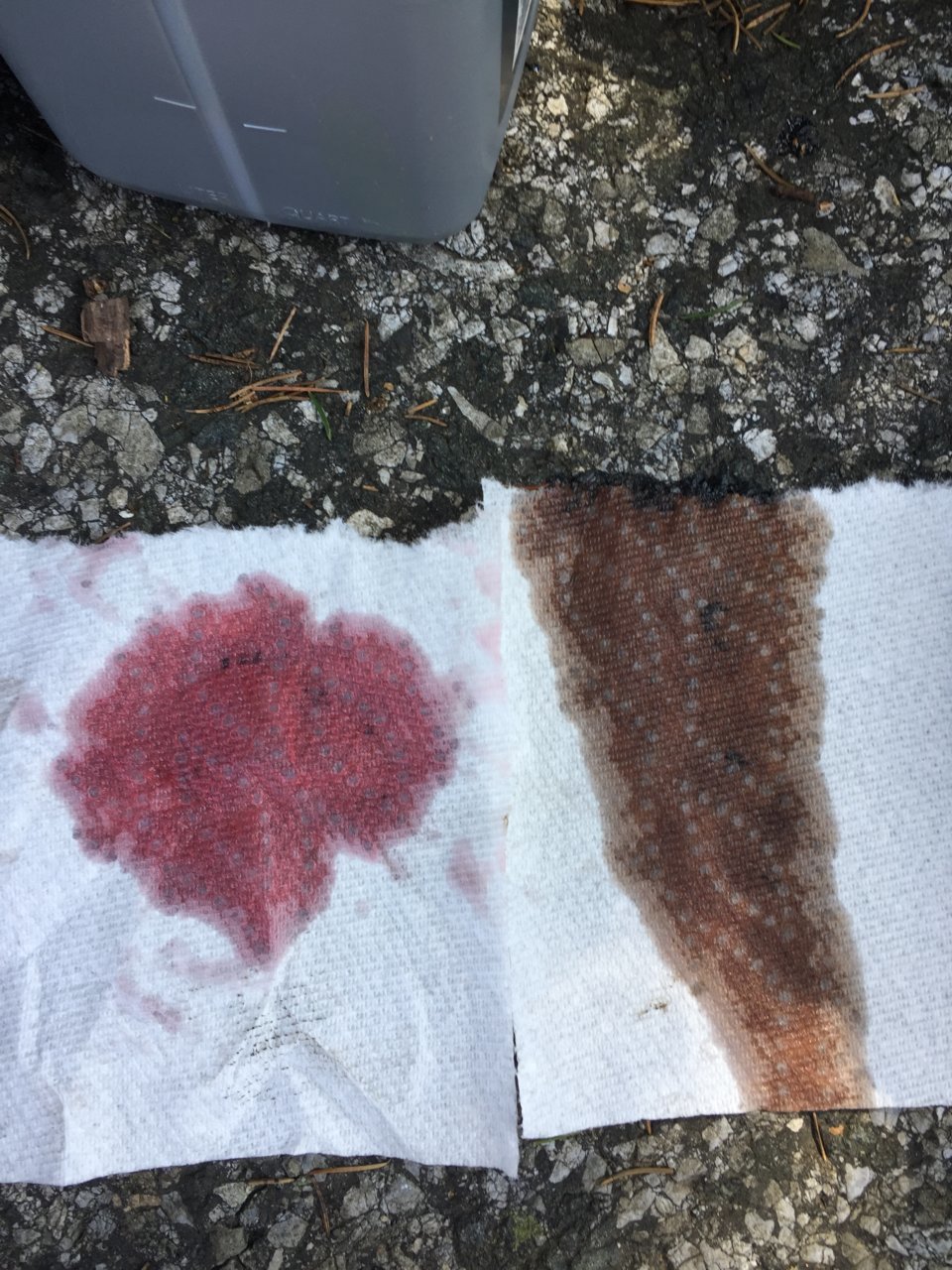

    Here’s what mine looked like vs new fluid after 120,000 miles. I did a full flush with new filter and it shifts great with no problems. You may as well flush your power steering fluid as well. Valvoline MaxLife synthetic ATF is great for both!
    spitdog likes this.
