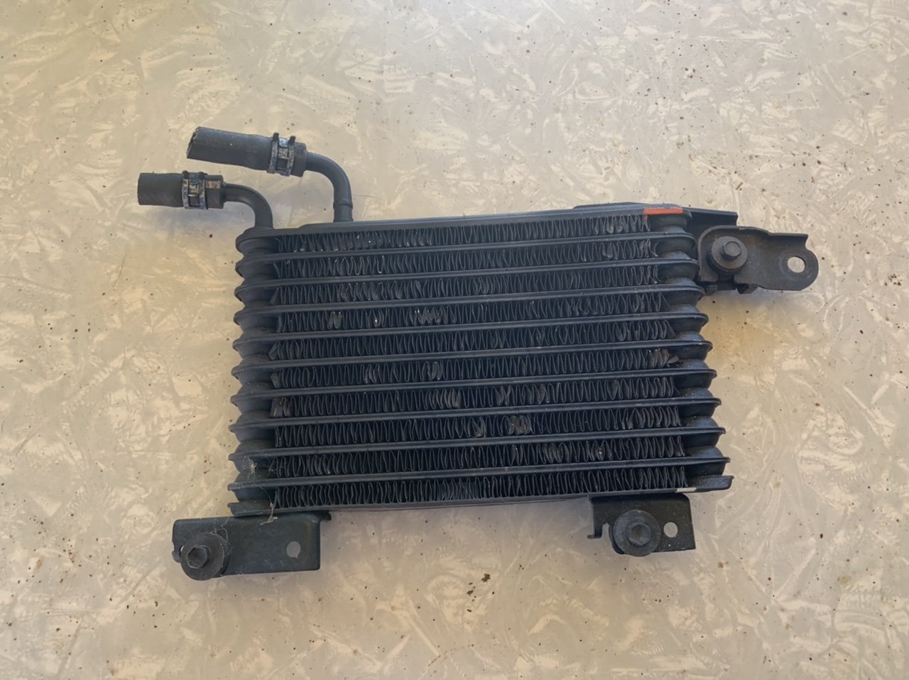

    I pulled one at a junk yard off a 4runner for 12 bucks just got to mount it and hook it up13449203-FC7C-45CA-84BB-D33672FF436A.jpg

    they sell various sizes of those on like orielly auto, not too pricey. it's the same design just more levels. I'm sure you could find them elsewhere. stock one is good but small, not sure how to install the "taller" ones. nothing special, same black paint. no need to get some super expensive one, just be sure to check your trans fluid levels after a few runs after
