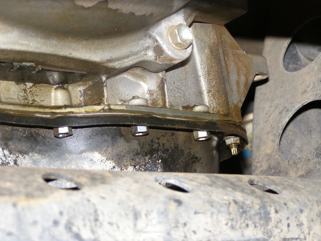

    So i was toolin around under my truck and i noticed this and being that im not mechanically inclined i have no idea what or why this is leaking.... any ideas?

    That would be the rear main seal leaking down the back of the motor.
    Standard or auto? Looks like an auto.

    u think toyota will cover that being that im still in warranty?..... without giving me grief about lift, tires, ect.?
    yea its auto

    I would think so.

    Lift and tires would not cause that leak.

    yea i imagine it wouldnt but toyota for the most part will try to get around anything, so i was just checkin to see. appreciate your help!

    Have you smelled the fluid? Don't laugh, haha. Oil and tranny fluid smell totally different. That will help you determine where the leak is orginating.

    lol, cant say that i have smelled it yet...... i will after class though.

    hey i know this is super old, but did you ever figure out what caused it / what did you do to fix it?
