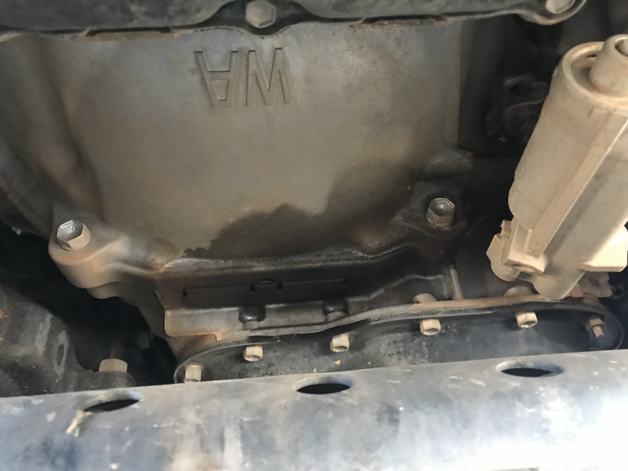

    So I just got under my truck to change the oil and noticed a pretty large leak area. Does this look like the transmission is leaking? I haven’t noticed any wet spots under the truck anywhere. 8CD0BB10-BE82-45FB-88E8-CE4D46EC6E88.jpg

    Did you trace the source up? Looks like it may be a little further up on the right hand side. Also need to make sure that it's the transmission and not something else leaking onto it and making its way down.

    Looks more like rear main seal. Your transmission fluid will be red.

    How many miles on the engine/trans?

    Pop the black plastic cover off and look in the space between the transmission and the engine. Could be your rear main seal if it's coming from there.

    Looks like rear main to me as well

    follow the oil trail up.

    Any luck?
    Just rolled underneath mine and sure enough I have the same leak....
