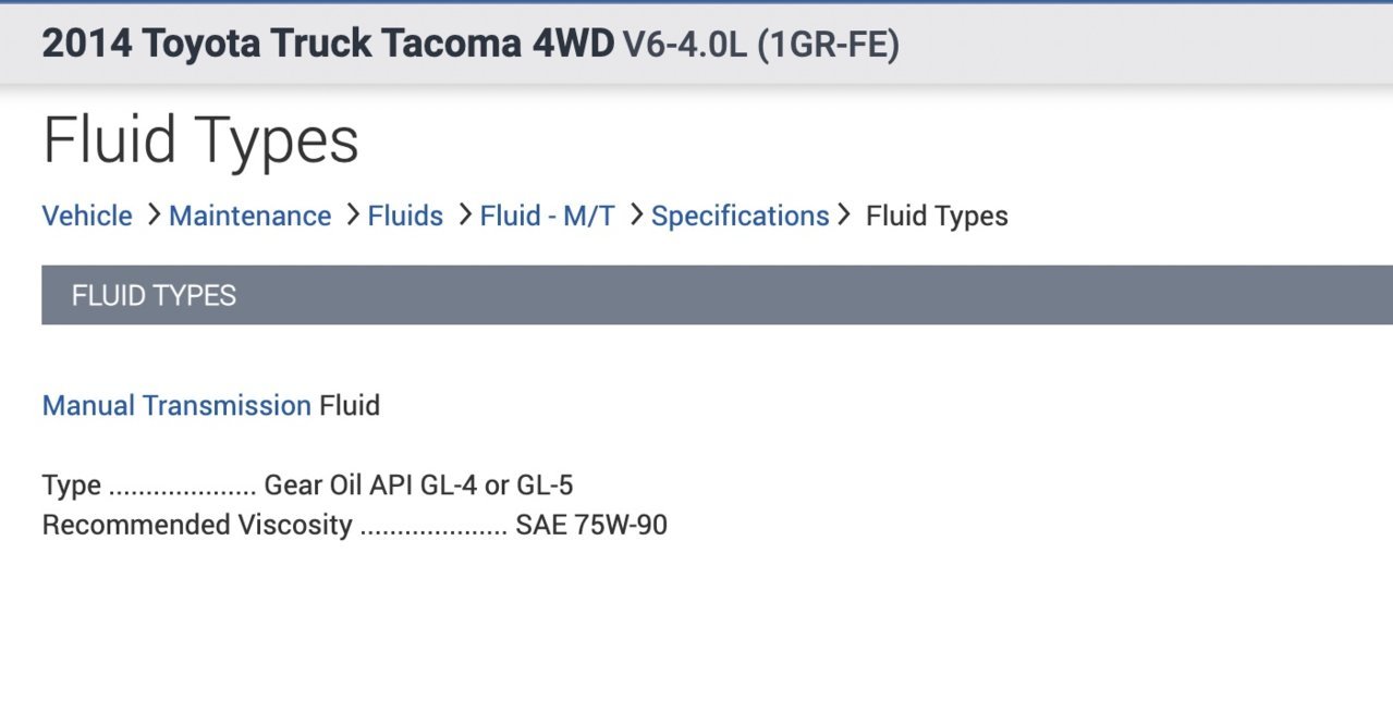

    Hmm. I should have done more homework before putting GL5 in the 6-speed manual tranny. Even though GL5 has more wear-reducing additives, apparently the additives tend to react badly with copper & bronze (the synchros,) which is why Toyota specifies GL5 for diffs & transfer cases with their all-steel gears -- but GL4 for the manual transmission.
    As soon as I can get some quality GL4 lube I'm going to swap that in to the tranny so I don't damage the bronze synchro rings.
    EDIT: On further research, according to the ALLdata entry for my truck, factory spec is for GL4 or GL5 oil in the manual transmission. I went ahead & ordered a gallon of RedLine MT90 (GL4) anyway. I'll probably try swapping back & forth over a period of weeks to months and see if I notice any diference at all in shift feel, noise.

    It's interesting that the factory spec says "GL4 or GL5". Also, semi-authoritative sources seem to disagree. This first vid is from a guy who specializes in manual transmission build/repair/rebuild, has looked at 1000's of transmissions and never seen bronze synchro damage related to GL5 oil use. He also took the trouble to contact transmission engineers for their opinions on the matter. He thinks the misplaced concerns often heard around the internet are related to old (>2 decade or more) GL5 formulations which have long since been amended not to cause any problem. His view seems to align w/ the factory spec of either GL4 or GL5 for the 6-speed MT.

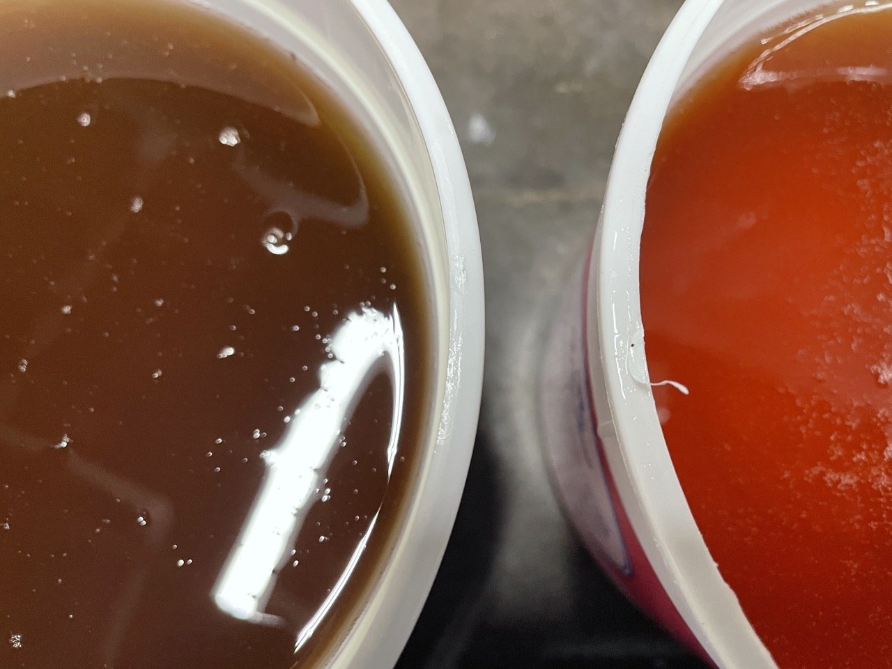

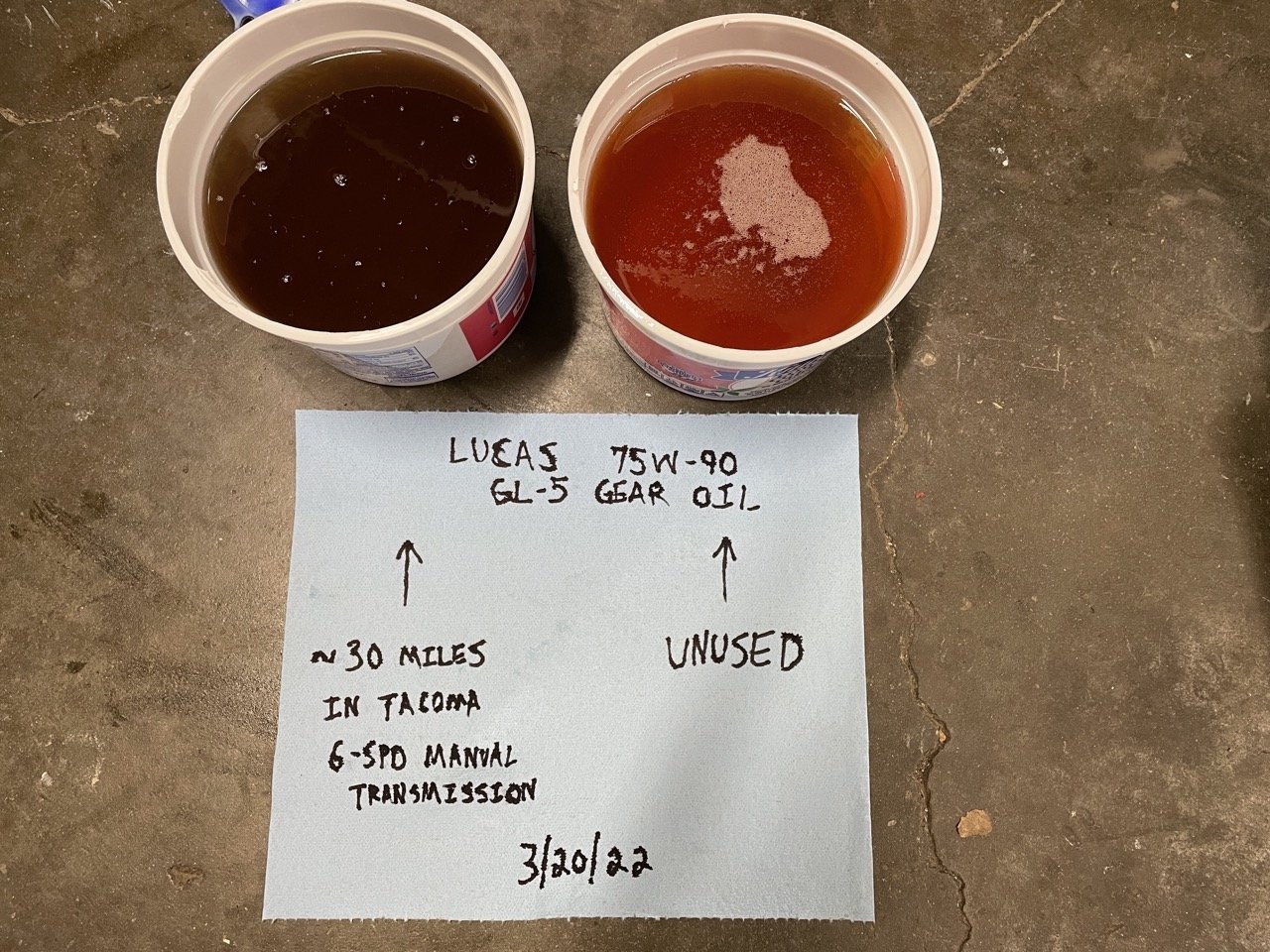

    For interest here's a photo of very lightly used (30 miles!) Lucas 75W-90 vs brand new Lucas 75W-90. I'm saving the used stuff to put in the diff of my old beater 1999 2WD Taco. This was in identical clean containers, filled to the same level, under uniform indoor lighting. Interesting to see a noticeable color change after just 30 miles. Maybe this was due to detergent package (?) in the oil dissolving some old tranny gunk. Probably also due to slight dilution with the previous old oil, which had 60K miles on it. (Not sure but I'd guess at least a few ounces of old oil stay in after a complete drain due to surface coating & interior case nooks & crannies.)
