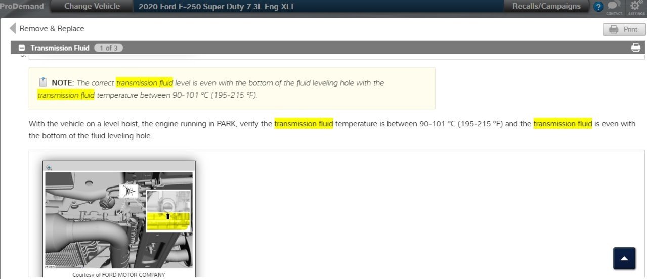

    Yea for sure, at least Toyota doesn't have you check it when the fluid is boiling hot like some others.
  13. Aug 11, 2022 at 8:31 PM
    #33
    Bishop84
    Bishop84 Well-Known Member
    Dec 17, 2015
    #172494
    11,771
    The hot method on the FWD models is 90c, fucking miserable. We use it when its past 45c. Have to use a special plug that raises the drip point.
    TnShooter likes this.

    Check procedure for a Ford 10R140
    SR-71A and TnShooter[QUOTED] like this.
