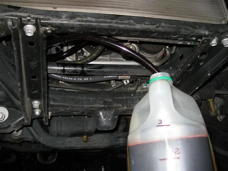

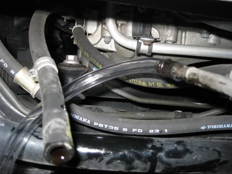

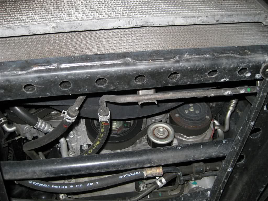

    My neighbor owns a 2008 silverado, and had the same problem. His were rubbing upfront between the coil and fender.
    Here are the lines that I'm talking about:
