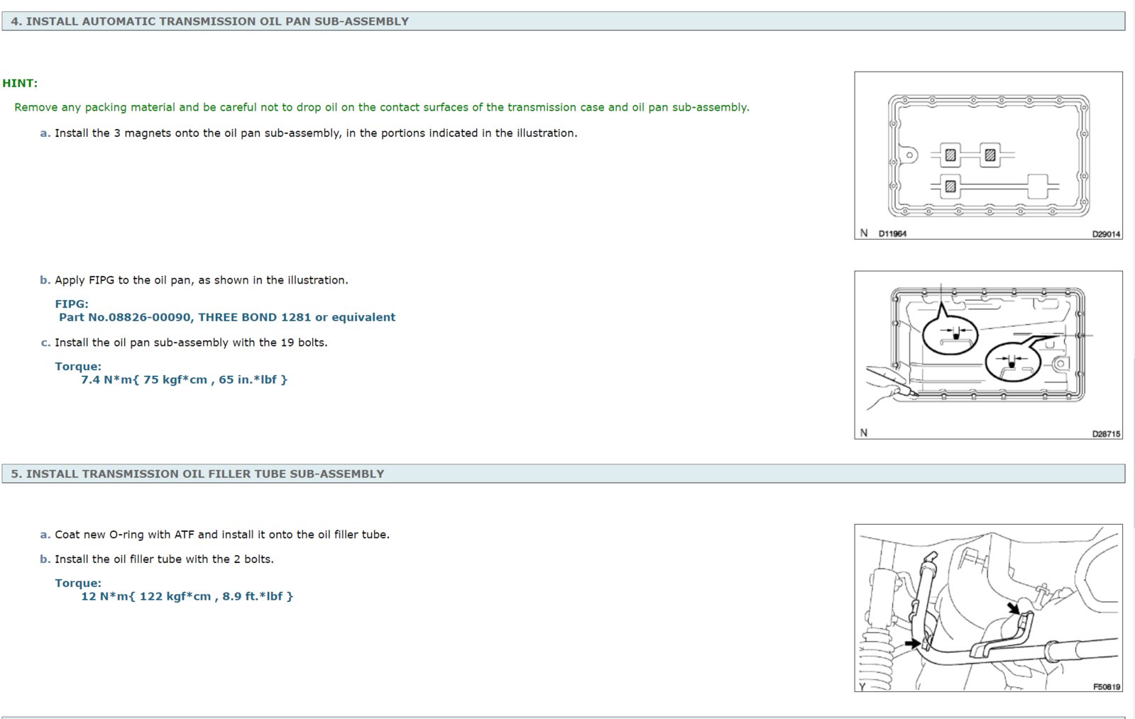

    It doesn't look like it makes any difference if it's 4x4 or 2WD.
    Toyota wants you to use FIPG (RTV).
    You can use a gasket, in place of FIGG / RTV, if you can find one.
    One bit of advice. make SURE the small bolts for the pan are DRY when you tighten them up. If the threads are wet with ATF fluid, you will over torque them and risk stripping the thread in the transmission. YES, it has happened. Most guys don't even torque them. They just snug them up.

    Just curious where were you able to get that document?? Looks awesome and id love to read it before i get into this
