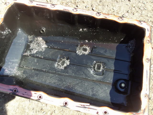

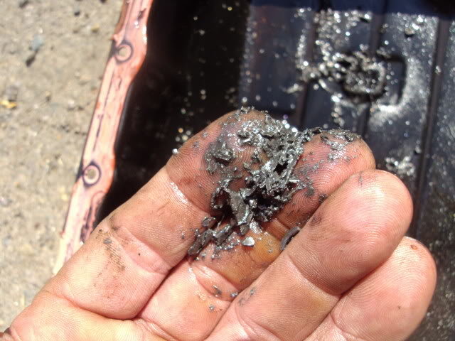

    I just changed the fluid...no issues in bottom of pan. Any other ideas? Anything electrical that might cause this issue? Sensors, etc?

    I have drained and refilled the transmission 3 times in the past 30 days. The first service I dropped the pan after it had sat on the rack over night to get more fluid out. There was alot of fine material on the magnets, but no chucks. The shifting seems to be improving, but not what I feel it should be. Still hard shifts when up to temp. You would think that Toyota would recognize this problem and correct it. Many have said that the Toyota world standard fluid is a lifetime fluid, and Toyota does not show a transmission service, only a instect up to 150,k miles in the 2006 Tacoma maintiance guide.
